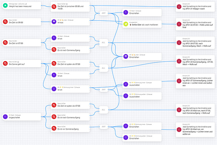

but you inspired me to restructure my advanced flow.
i started with having triggers multible and conditions only once, but now i changed like you to have each trigger only once, but conditions can be more often in one flow. feels better…
so from here:
to here:
More wrinkly lines is more better :slight_smile:
You way worked also…
I notice this:
Does “any” work in both ways ? I figured it worked “left to right”, any condition met would lead to the flow continuing, it also works the other way around? So all actions will be taken ?
Would it not also work without the ANY ?
yes it works in both directions, all actions will be taken.
i only use it for more structure :slight_smile:

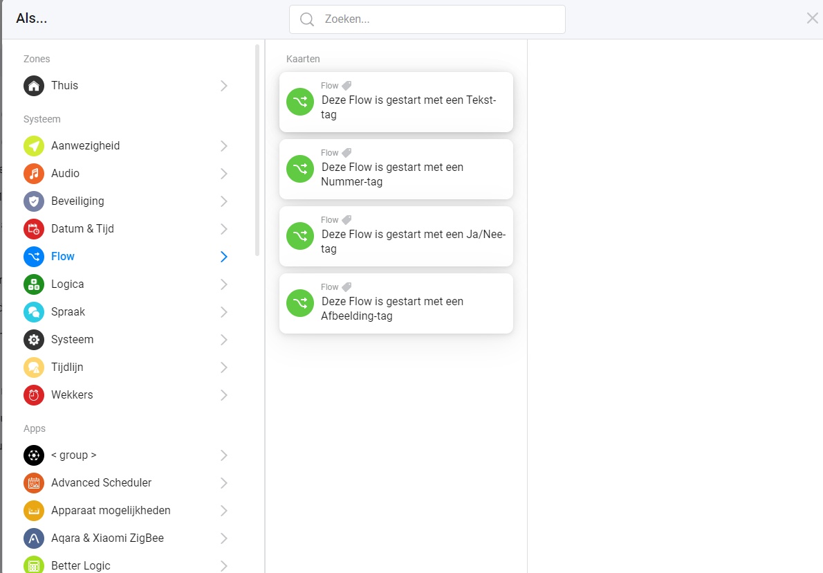

I’m missing a card in “ALS” (IF) → “FLOW” when i use Advanced Flow.
It’s the card with only “Deze flow is gestart” (This flow did start).
I did try a view times but i don’t see this card any more in Advanced Flow, i still can see it in the “normal” Flow.
Do i something wrong or is it a error in Advanced Flow?
Thanks for helping.
In “normal” Flow:
In Advanced Flow:
That one has been replaced by the play(Start)-button.
You just use the Start option instead
