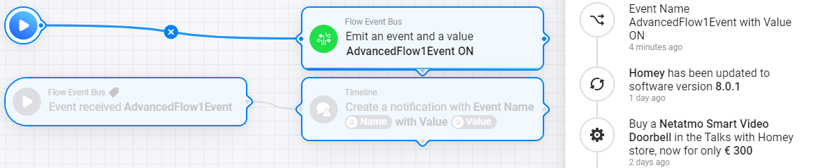

Is This about Flow Event Bus ?
You need to connect the Cards first, it works!
Strange, I use the Dutch version, so I expect the logic “Waarde” in the list, but I cannot find it.
Other variables are no problem, only in the events app.
Sorry, my bad Geurt!
I did not draw the line from the event to the else…
So he didn’t know I wanted that value.
Solved, thanks!!
