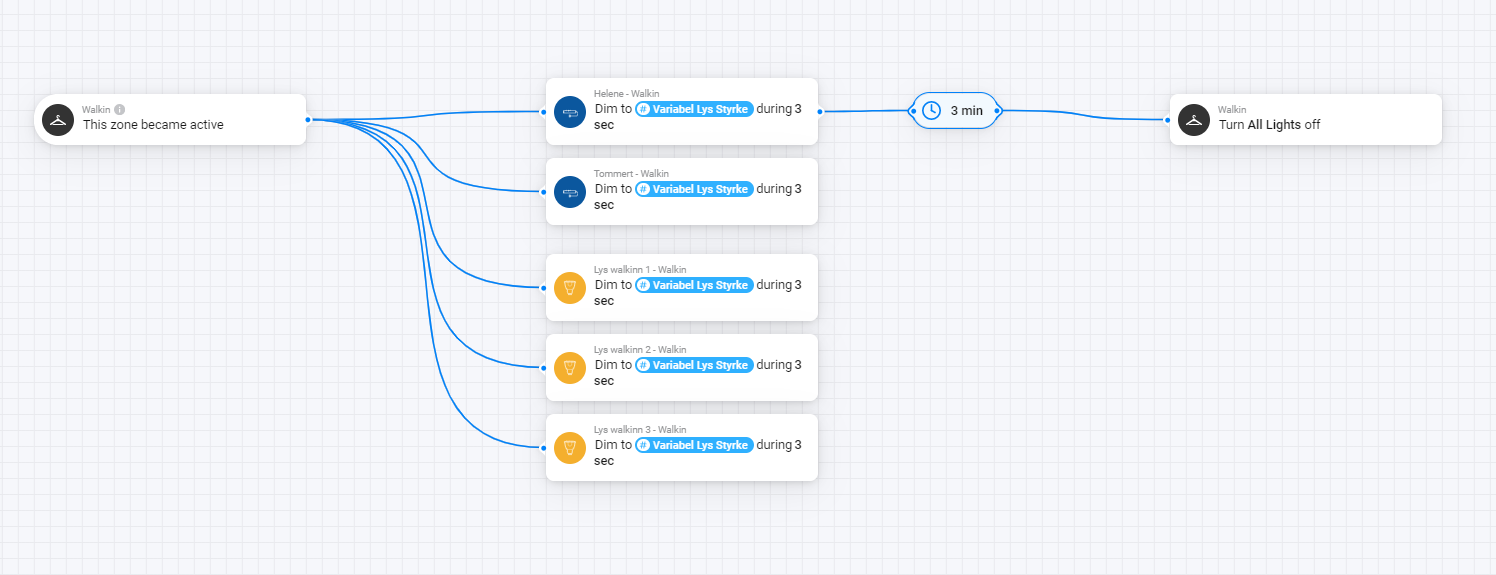

Does anyone know how to do a motion → lights on → delay → off correct?
A simple flow is running at my walk in closet. Motion is triggered, lights turn on, the delay runs and the lights go off.
But if i enter the room after 2.5 min, the timer does not reset and the lights turn off after only 30 sec.
It seems as the timer keeps its delay running, even with a second trigger signal.
Is there a option anywhere to reset the timer when motion is triggered a second time?

The big pitfall with motion…
You should switch the lights ON when the zone becomes active
And switch them OFF when the zone becomes inactive (if needed “is inactive for a certain period of time)
Zone activity won‘t work if you also have a contact sensor in that zone (open window).

In that case you could consider moving the window contact sensor to it’s own zone. But do not use a subzone though (they activate the parent zone as well)
