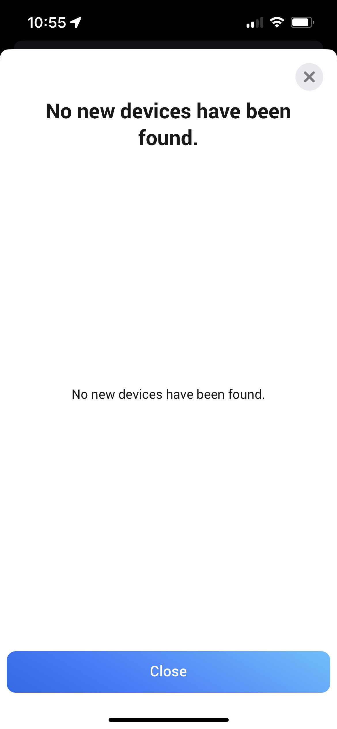

I installed the test version, went into the app settings, Get Hub Device and got this:
After this i added a new device, custom IR remote, connect, signed in with my credentials, ok, and there are no new devices found
Any idea? Am I doing doing something wrong or is the test version not working for me?
I am on a Homey Pro early 2023, version 10.0.0-rc.100. Only lan is enabled. Web app 1.9.39. Also tried this after a restart of Homey. Also tried on my Homey 2019, same result.
Could you tap on the Send Log button so I can copy the details and I will add support for that type of remote.
Done
I also tried to add a lg TV remote. Did not work also at first. Deleted the app, restarted homey, installed test version. Had to wait for two minutes(sooner did not work), after this went into the app settings,get hub devices, and two remotes were found. Dyson and LG.
Added a device with switchbot. LG was found, Dyson at this point(you are working on it) not.
It can take a few minutes for new devices to appear in the API list after adding to SwitchBot.
