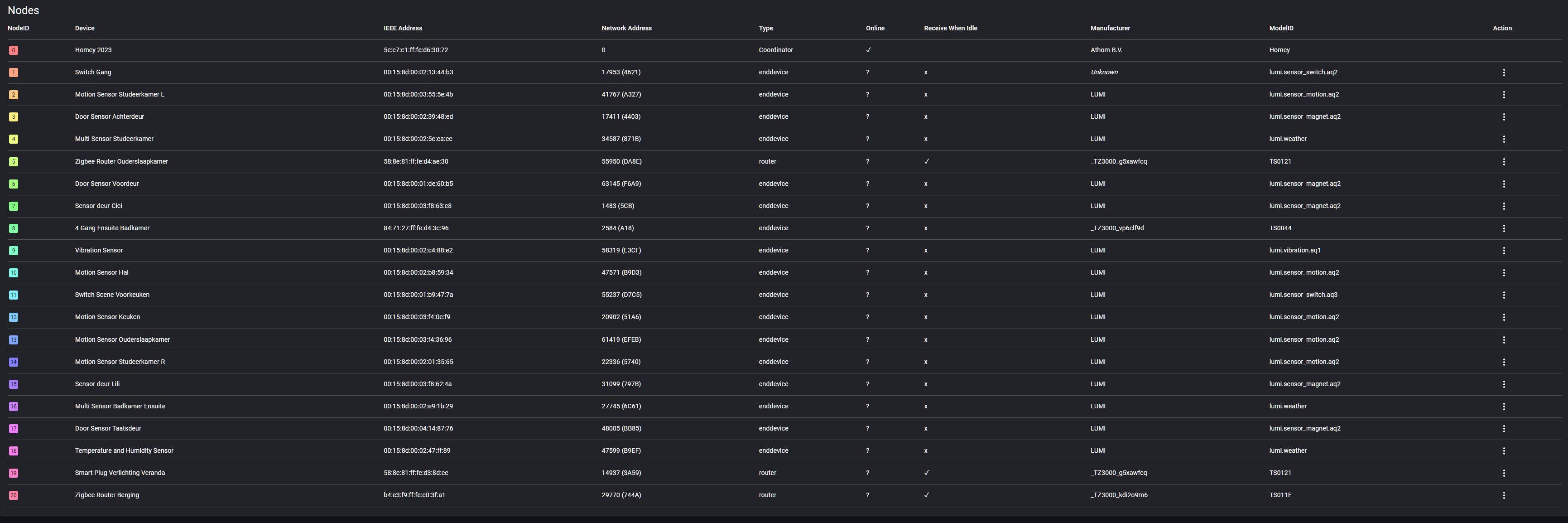

So just to confirm. Aqara Zigbee devices stop working on your HP2023 too? is there a mesh in your developers overview?

I don’t see mesh info either, but by far most devices work fine so I don’t think that’s the issue. Is it possible you are experiencing 2.4Ghz wifi interference as well? In my case I noticed before with Deconz that this usually means that at night or early morning (when there isn’t much wifi activity) everything works fine, but during busier times things become unstable.
