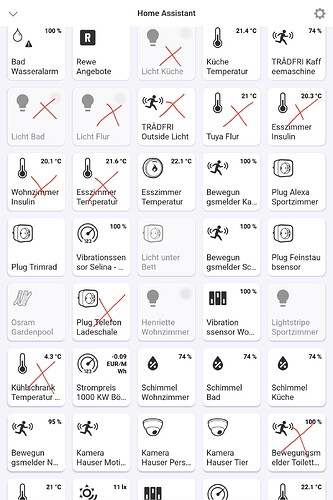

If you are talking about HA devices (Deconz imported to HA and then imported to Homey via Community app), you can:
  • check your HA entities and their domain (the prefix of the name like button. or sensor.
  • check the entity state or state changes in HA developer tools. Search for your entity and check if the starte is changing when pressing the button.
  • check the events in HA developer tools if events are raised when pressing a button.
I can only show you the event version. But it’s also documented in then HA thread.
Here is an example with a sensor representation.
