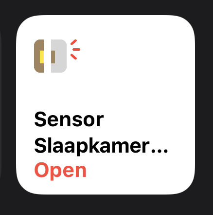

What I did is removed one contact from Homey and added it once again. Via Developer Tools I can see that it is added with the correct Class. See below.
Property Value
ID 48de91dc-5761-487e-8121-4bfe8a01e99e
Name Sensor Slaapkamer Dion & Kim
Class sensor
Driver homey:app:de.dresden-elektronik.deconz — aqara-magnet
After this action also available in Apple HomeKit!
