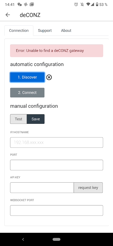

deConz app looks so:

Right, so we can safely assume it’s either the config inside the app in homey. Or your deCONZ server / service is completely dead.
What happens if you click the discovery button.
it says “Error: Unable to find a deCONZ gateway”
Just to be absolutely sure: you have either a Conbee (II) or a Raspbee (II) device, right?
I have non of them but as I said, I also haven’t had one bevore and three days ago it worked
That’s simply not possible. You need a Conbee or Raspbee device for deCONZ to work, and you need a working deCONZ setup for the deCONZ Homey app to work.
Trust me, it worked before :slight_smile:
I think you paired the Sonoff device as a generic Zigbee device (Devices > Add > Homey > Zigbee), because all it needs is on/off support which Homey supports out of the box. The deCONZ app requires a working deCONZ setup, and if you don’t have one, the app cannot provide any device support.
