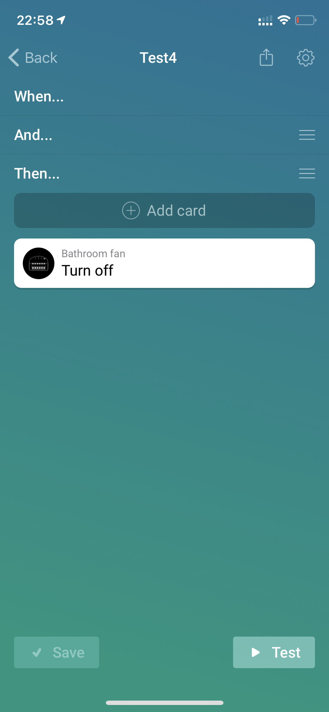

First thing is that i had to use variables because there arent button options past button 5 in the When… flowcard: see picture here:
And then used variables to define the correct button and action (ie hold or push. BTW double and triple clicks didnt also work for me):
And the outcome should be for example turning off the fan:
This exact flow works from button index 1 to 6 but not for 7 and 8.

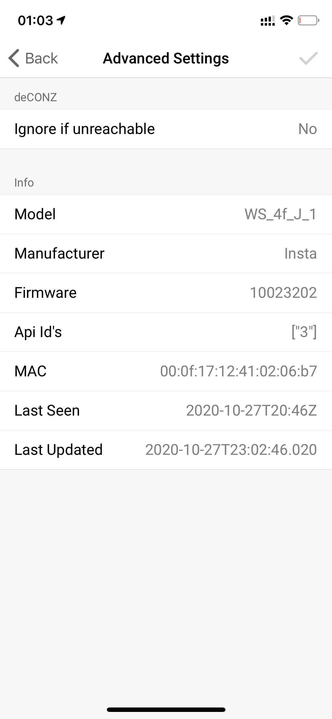

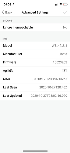

  • what is the modelid of the device? Go to the device settings and then to advanced to see this
Device model:

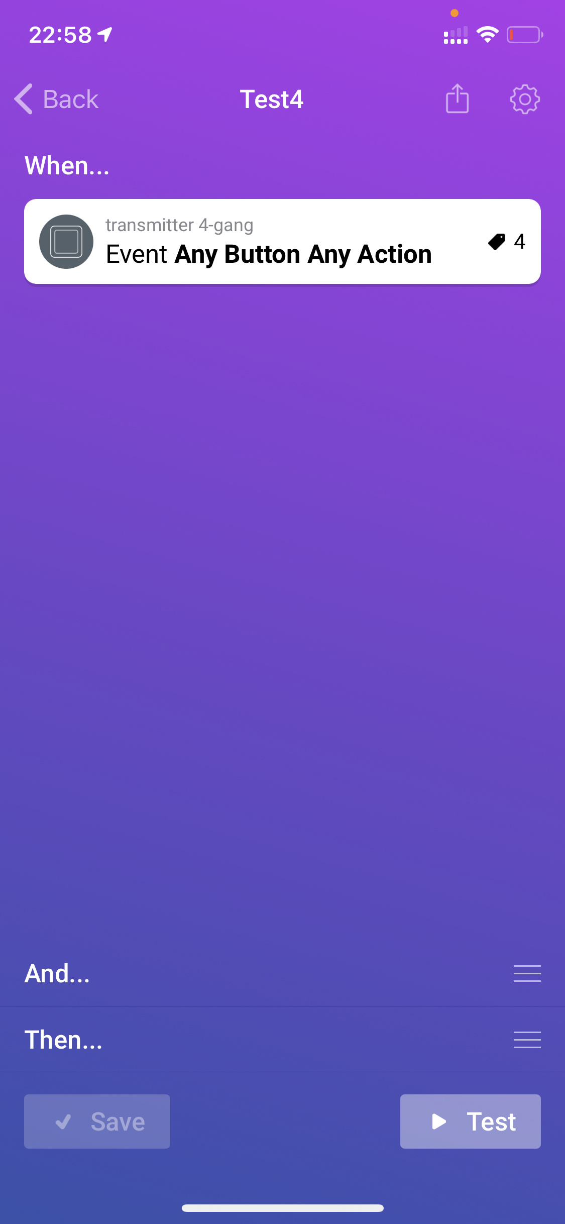

  • create a new flow card that uses the “event” of your device. Set it to “any button” and “any action”

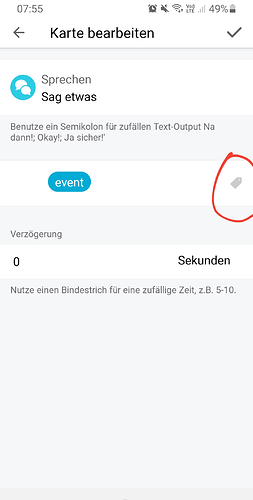

  • in the action part of the flow card use something that can give an output, for example the “say” action
  • in the text argument there is a little tag icon, click it and choose the event
if you then push a button it should say something like “1002”. This is the code I need!
Ok thanks a lot. Got the codes:
(left bottom) button 7 - 7002
(right bottom) button 8 - 8002
Basicly i could use the event variable and use these codes also and it should work?
Thanks, exactly what I expected. Yes you could use that and it should work but I’ll add a new driver anyways for better support.
Is this the device you have?
Thanks! I’m feeling really positive about the homey community. Really appreciate your help.
And yes, it’s the same device.

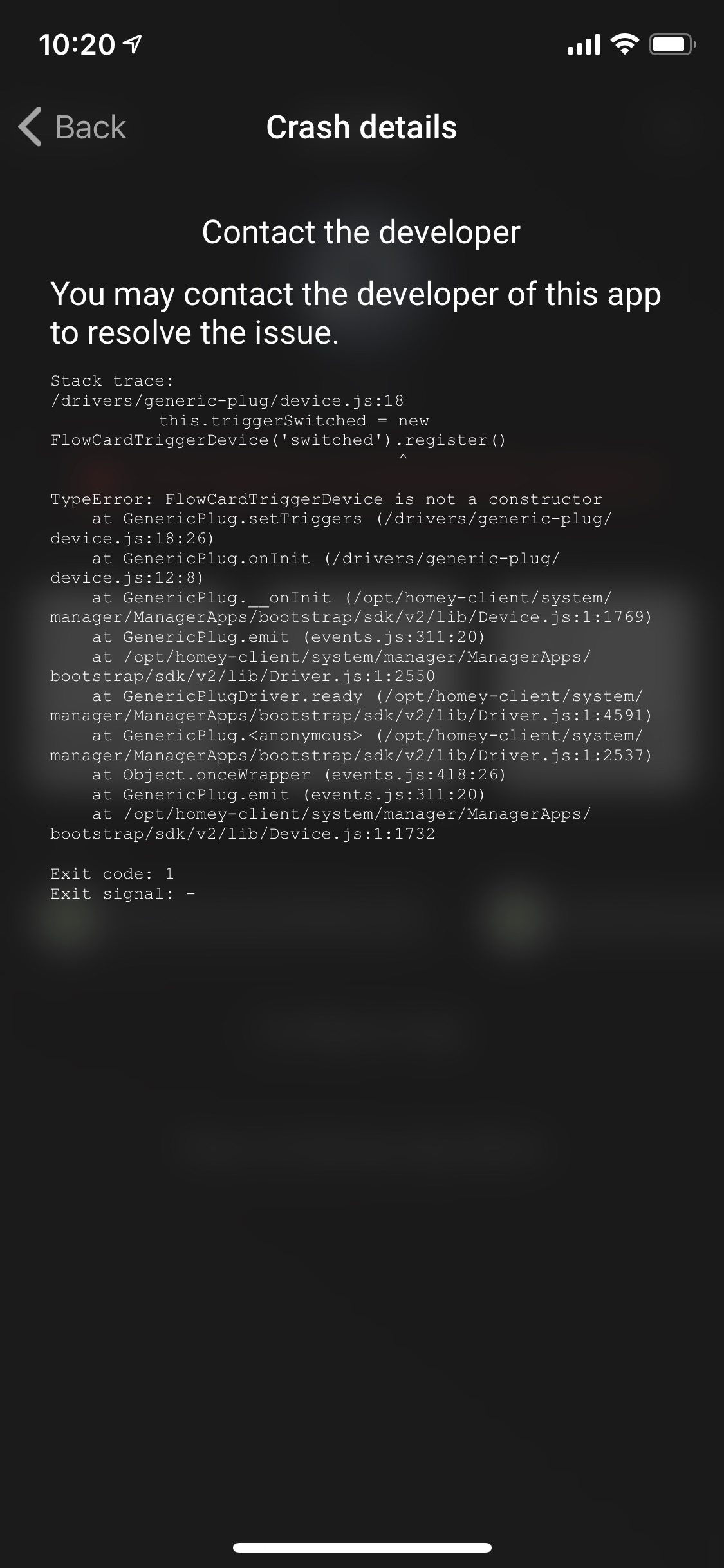

I just saw that Deconz has updated to 1.16.0 a few minutes ago, and since then I have a bit of a function breakdown here. :frowning: The app seems to crash and is not running anymore.
Before I start to change anything here, I wanted to make sure it is an issue with the update. Any similar observations?
Johannes
Yeah same. Since update all deconz devices fail to trigger.
Sorry about that, this is a small bug that applies only to the users that have a generic plug device. It should already be fixed, If you can’t wait you can install the fix from here: https://homey.app/de-ch/app/de.dresden-elektronik.deconz/deCONZ/test/

Install test now (1.16.1).
Seems not to crash anymore.
