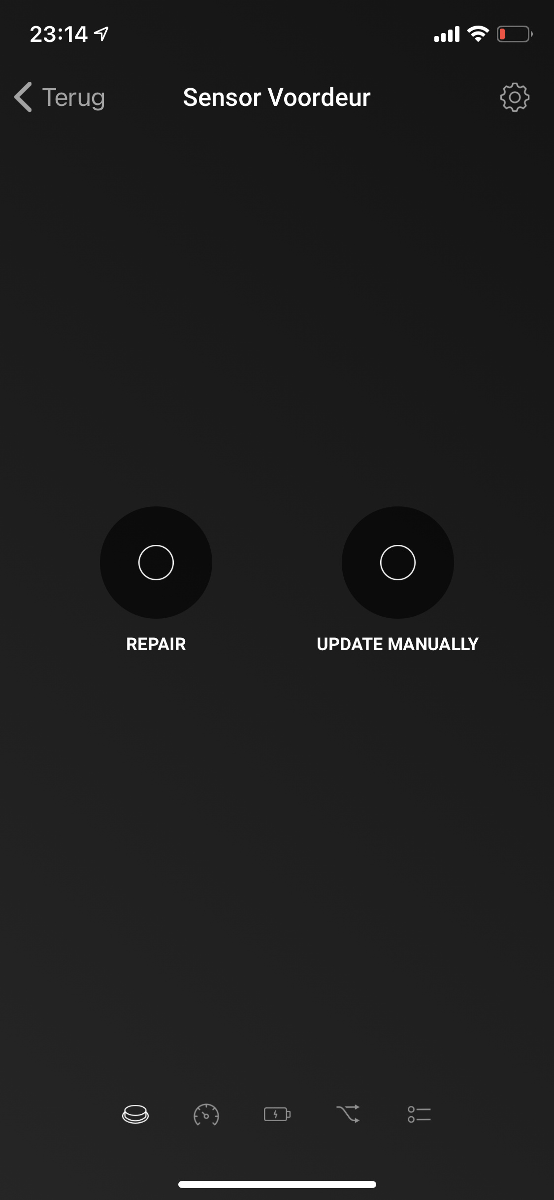

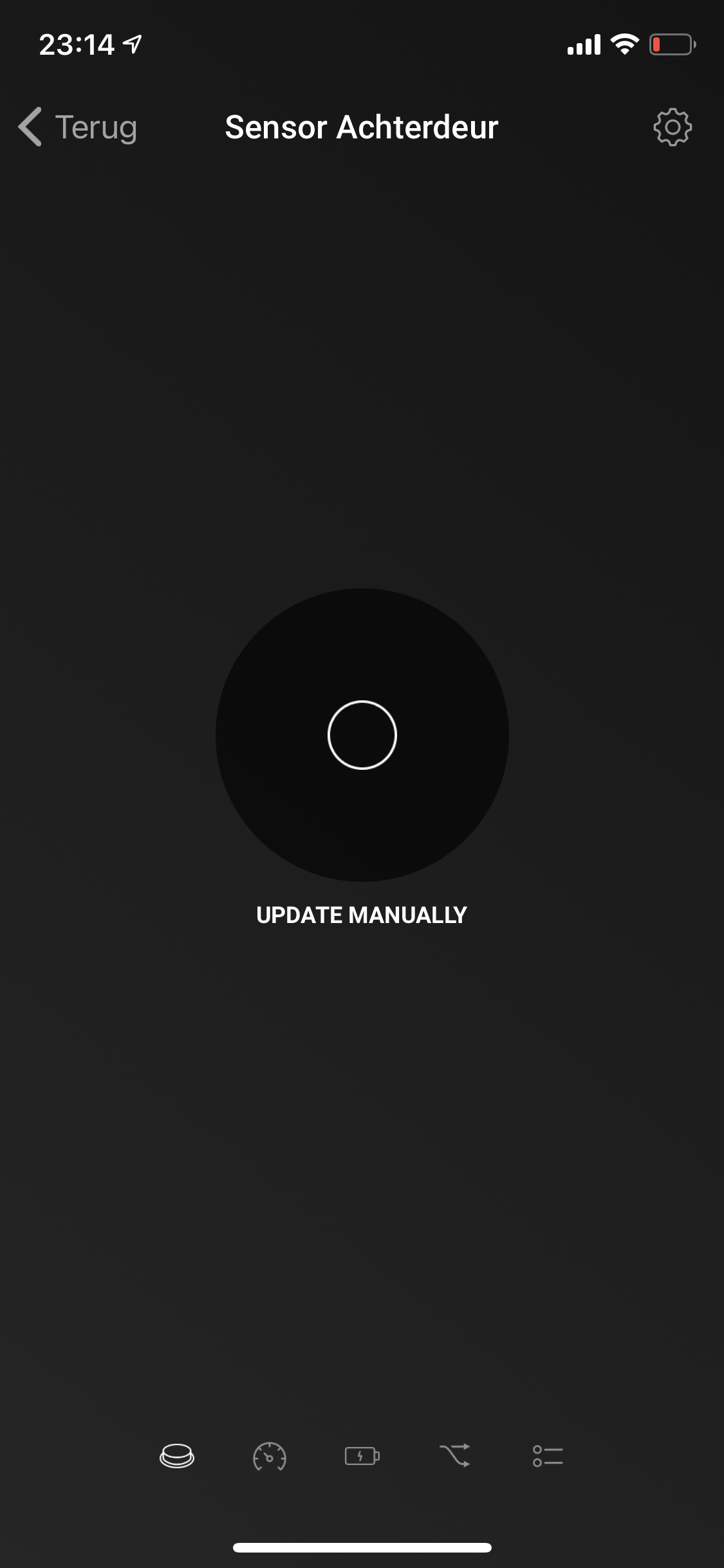

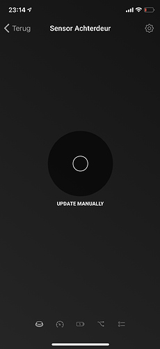

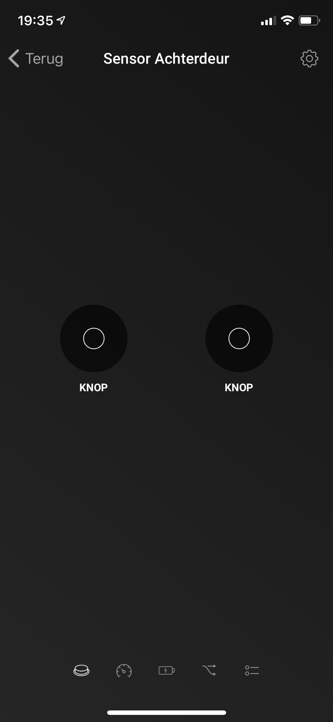

Added some pictures to see what I mean.
You are not the only one. I’ve got those buttons too in homey. Same goes for the homekit application. I can turn ‘off’ the Kantoordeur for example. Maybe @MadMonkey and I don’t know if it is possible to transfer these update/repair settings to the advanced section of the devices. My best guess is homekit now gets the ‘button’ information from homey and thus thinks you can turn it off and on…
