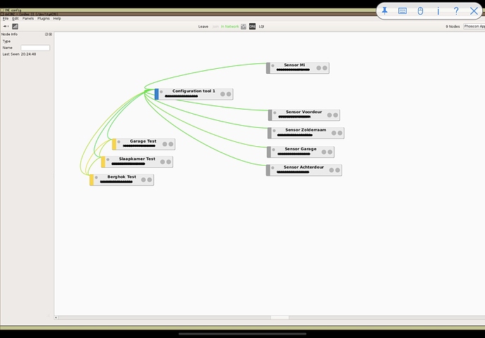

After a few weeks of not using deCONZ I tried to configure it once again. But this time in a small setup since I had a lot of troubles within the last config.
Before I started I made sure that the firmware version from the Conbee II stick was up-to-date and I installed the docker (on Synology) with the latest version from Phoscon. Everything is starting fine. I can add my powered zigbee switches (routers) to the application. In the web interface, and via Homey deCONZ app I can switch them on and off. Even the Zigbee map looks good with interconnections between these switches.
After using (testing) this for a few days I started to add Aqara door/windows sensors to the configuration. Via the web interface everything went smooth. They are nicely connected to the routers and twee direct to the coordinator since there is nog obstruction for this signal. See picture below.
But… after 1 day I lost the connection on 2 (backdoor and Garage) out of 4 sensors.
To reconnect them I need to search for new sensors in the Phoscon web interface and then press the button a few times on the sensor. Then it will be connected again with the default name. After this action the sensors are reconnected again to a router. But again… after a few hours the two sensors disconnects again.
Does anybody have this same problem? Or recognizes this problem?
The Zigbee switches which I use are Tuya TS0121 (link)
What’s strange is that the signal seems to degrade: looking at ‘Sensor Voordeur’, it has a good (green) connection in the first picture and a bad (red) connection in the second. That’s not something I’ve come across myself (although I have a Conbee I, not a II, but I don’t think that should matter).
Assuming that the router devices are always powered, perhaps you need to rule out a specific issue between Aqara and the Tuya switches, for instance by adding one or two IKEA repeaters/devices to your network to see if the same thing happens.
FWIW, I have three Aqara contact sensors that have worked fine for over a year now. I mostly use IKEA router devices myself (bulbs, sockets and repeaters).

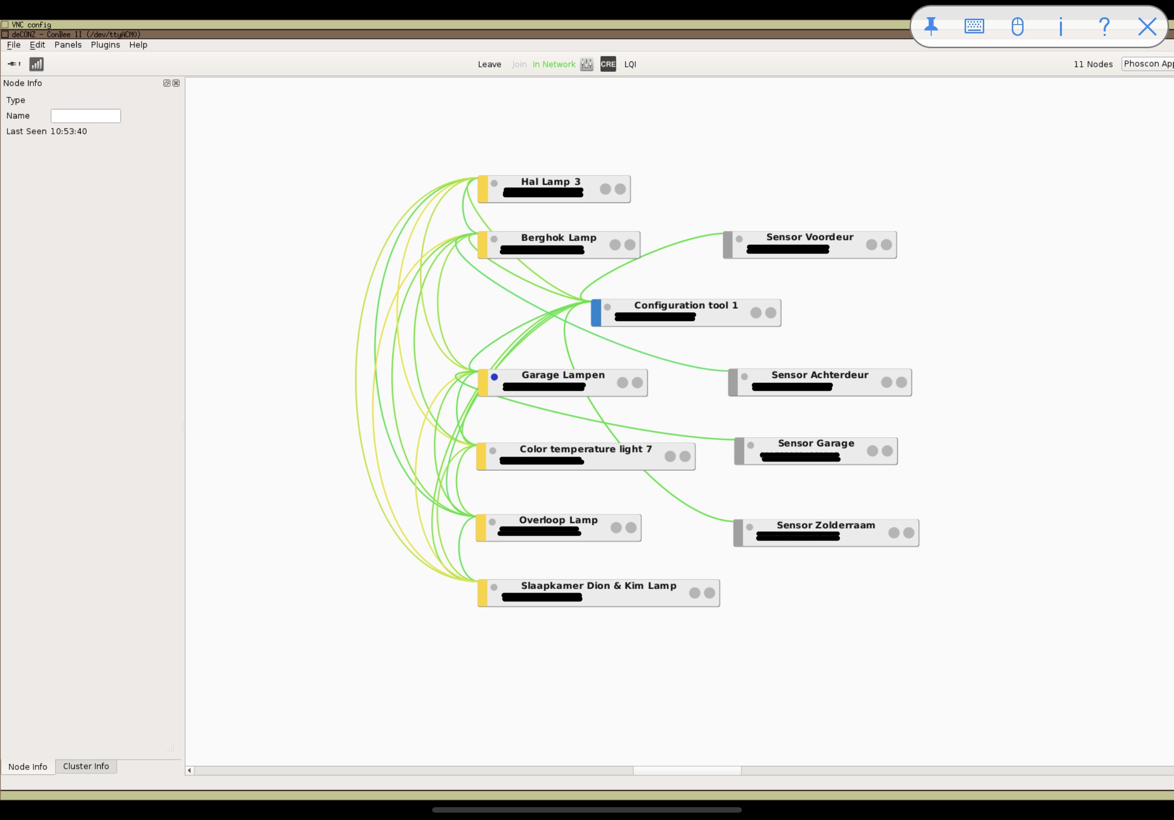

Thanks for your response @robertklep. It is strange yes.
I did some changes in my setup this evening. I had some Ikea Tradfri spare lights (3) and placed them on strategic places in the house. Next I restarted my deCONZ setup. All lights are connected to each other. See image below.
But the strange part is that the Aqara sensors are all directly connected to the coordinator.
I am curious what will happen after a few hours as of now. Why does it not use the routers to connect the Aqara sensors???
The “Sensor Voordeur” is approx 5 meter from the “Berghok Test” light. The coordinator is two floor up. This to have an idea how the routes should be.
Aqara sensors tend to not change routers once they have paired, that’s why it’s important to pair them near their final location in your home, and after you added any additional router devices. It may work to remove the battery from the sensor device for a few minutes and try again, they may end up using one of the router devices instead.
Alternatively, put the sensor in pairing mode (by pressing the button until the blue light starts to flash) and re-add them to your network. If you don’t remove the device from deCONZ/Phoscon first, in my experience they retain their (deCONZ) id (which is a good thing).
