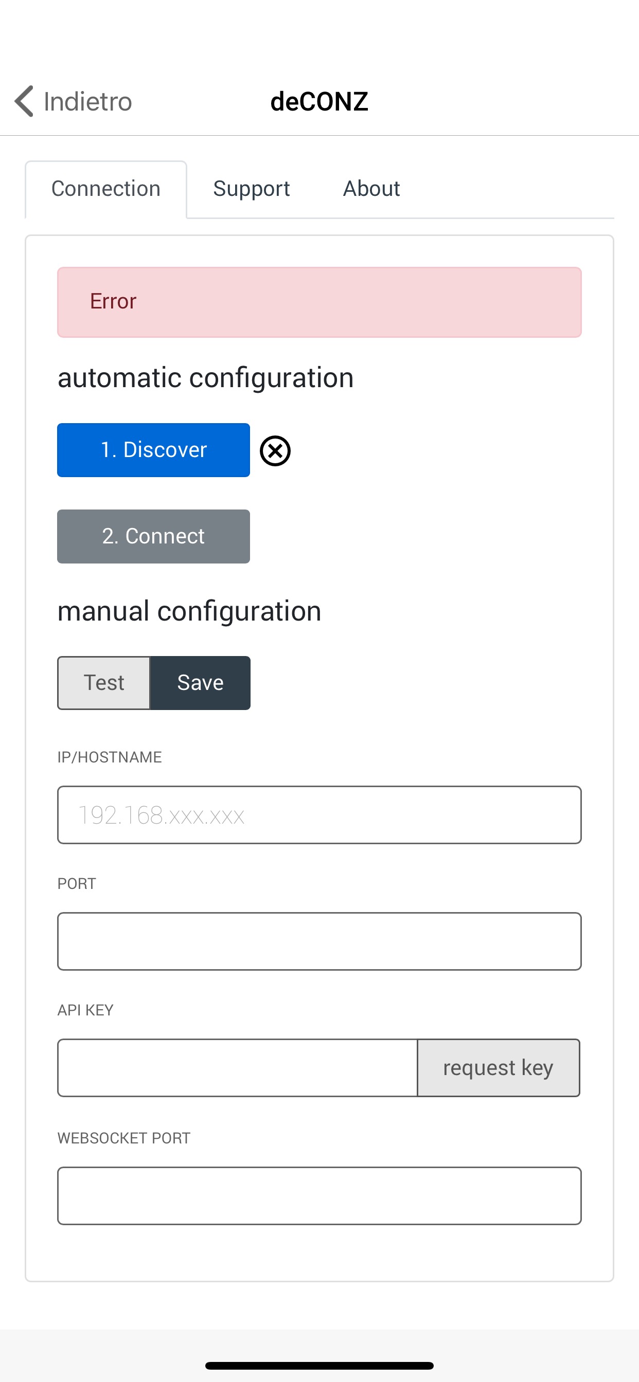

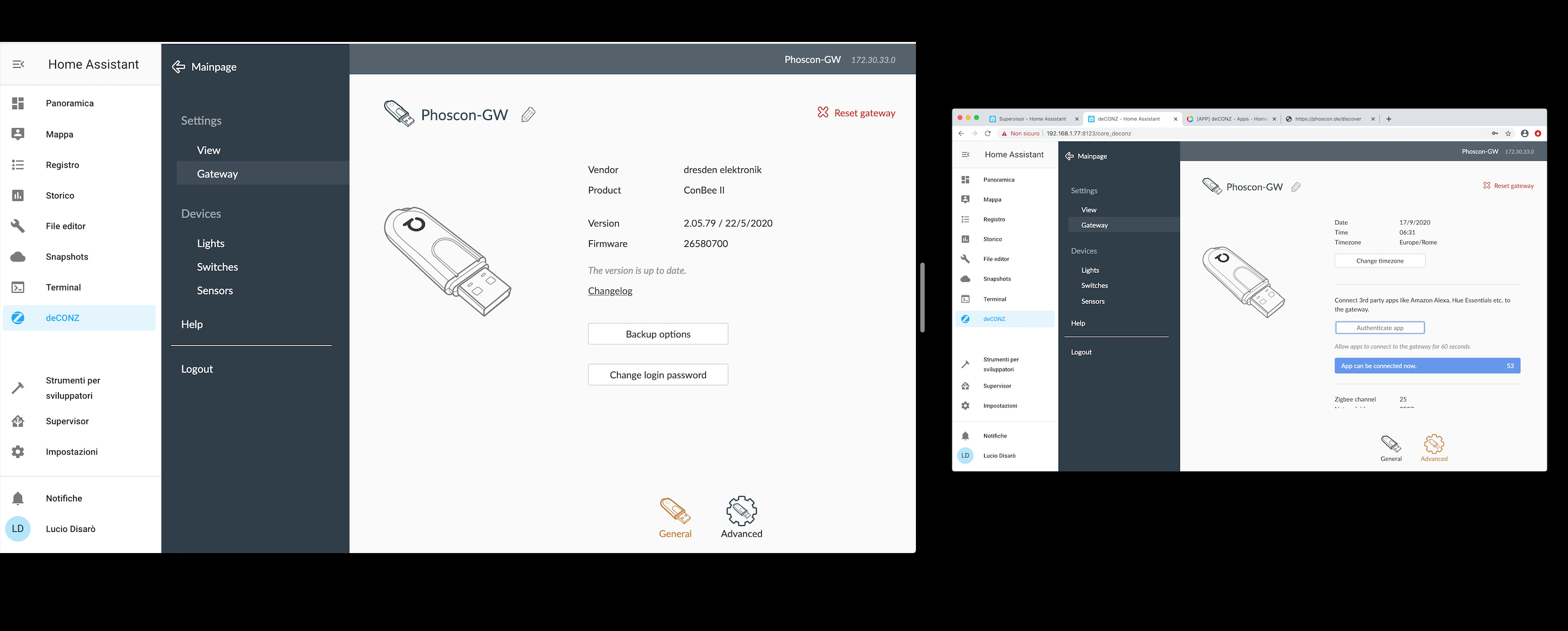

I have been trying to connect connBee2 to homey for several days. I followed the instructions but I always get a generic error !!! where am i wrong?
the conBee is connected to a raspberryPie 4 on which HASSio is installed
thank you so much!
second message only for attachment
You’re running deCONZ/Phoscon in a Docker container, in which case auto-discovery will not work unless you’re using the macvlan network driver for that particular container (but since you’re using Hassio, which abstracts a lot of that away, I don’t know how you would need to configure that).
