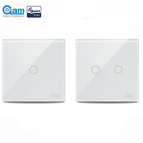

This could be an option:
Okay, i guess we don’t understand each other… :wink:
