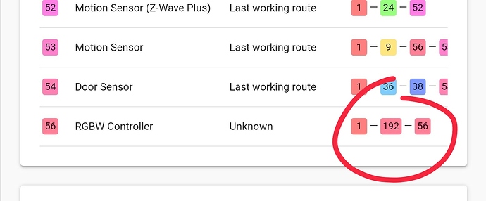

@Caseda Yes but that happens more often. And is usually straightened out with a heal action. Now this doesn’t work and the random placeholder looks worrying, like a software glitch.

I have tried to heal, test frame and test without success
I have 2 fibaro that was associated with my another zwave box (i’m migrating room after room from it to Honey)
I have removed this 2 fibaro from the old box, and associated to the homey.
Afetr that I have made a “send test frame” and “heal” on the faulty RGBW
The way is now correct, via one of the 2 newly homey-included fibaro :slight_smile:
Maybe this fibaro parts not included on the honey was the problem
Now, the way isn’t the best one, some instructions are lost, but it works. Before that, with the ghost “192” node, it never works.
Thanks again :slight_smile:
Hi, I just moved from SmartThings to Homey, and I’d like to know how to access this screen/tool.
