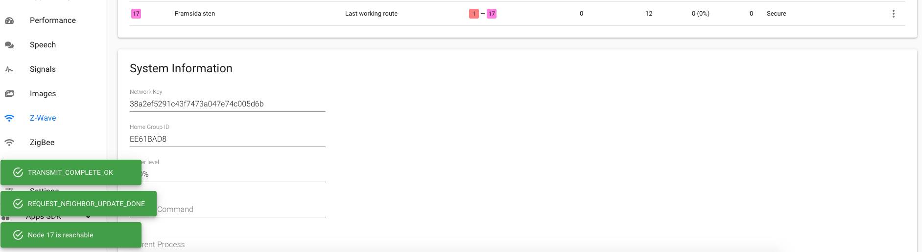

I am experiencing a weird issue where everything looks ok with my Zwave device in the developer page but when i try to turn on the switch i get a timeout.
Any pointers?

Today I tried to remove device and add it again. When adding as secure I got the same issue as before but when adding without secure it worked.
