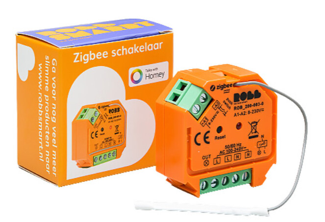

I have Recently added 2 pcs of RobbSmarrt Zigbee ON/OFF switches:
Also there aer 3 pcs of RobbSmarrt dimmers.
Now: Wheneven I have to powercycle my HP2023, these 2 ON/OFF modules fall off the grid. :slight_smile:

When I pair them again, the connection is okay… Yesterday I had some issues with my Homey where I decided to Restart. Again, the 2 modules are disconected
Strangely I can ping the modules without problems from the developers dashboard. There seems to bee a connection, where the app tells me te opposite

I seems to be a known issue, where after powercycles or auto-updates where hp reboots, the zigbee module is not done initialising, where hp completes its boot.
It seems devices pair up without being able to connect. This results in an error state that does not gets cleared.
Solution till this gets fixed by robbsmarrt…
Switch experiments on. Create a flow where after reboot the robbsmarrt app reboots aswel.
I hope this works. Credits to athom for their quick respons.
That fix is already released with v2.8.0 of the ROBBsmarrt app.
