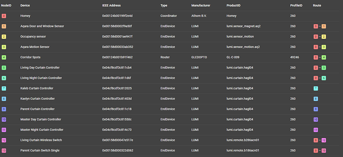

Hello, I’m having trouble controlling the Aqara B1 Curtain Motor, particularly Devices 10 & 11 which are furthest away from Homey. I don’t see a 0 - link for devices 7 to 11. Can anyone help me understand what this means? How do you tell whether a device is linked in mesh or not?
Thanks in advance for the help.

I had the same; I have over 80 Hue bulb in- and outside of my house. The Aqara sensor would not route over the Hue Bulb.
So I bought 4x Xiaomi Aqara Smart Plug thinking that would help. It didn’t. The Aqara sensors would not route over the Xiaomi Aqara Smart Plugs…
Then I read people had good results with the Ikea signal extender so tried that; Worked like a charm.
I ended up buying 4x extender and placed them strategically. Sensors working like a charm now at the end of the garden
Aqara sensors route over both Hue and Innr for me. But they do not switch routes easily, so make sure you pair everything in the olace you intend them to be.
You have a lot of end devices and only one router that I can see. You’ll definitely do better with more routers. If Homey is the closest device they see you will soon run out of the max 15 or so directly connected devices. You may need to pair Aqara devices again for them to use the router.
