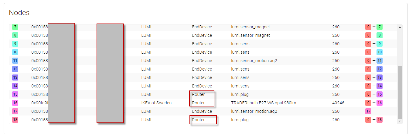

Have you been able to check the routing?
The routing doesn’t seem to update, even after several minutes.
I think all your devices are battery operated, only a mains powered Zigbee device can act as an intermediate device.
OK, should have added the second half of the screen (below).
Indeed, battery operated nodes can/will never act as a router. Makes sense since if they would, their batteries wouldn’t last the day.
So, having established that there effectively are some routers in the mesh, I thought the value “0” would change over time for something else? But as it appears, there is no automatic “heal” function. You seem to be able to force it though (haven’t tried yet; will report back):
Br,
Yep, I checked this morning and saw some indirect routes to Homey!
sweet!
Thnx!
Taking the power off, did the trick!
I do have a nice mesh now.
Thank you for your feedback!
