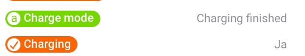

@pwad : Start / Stop / Disconnect / Connect Flows successfully tested! They work as expected. Good job!
There is a issue with the boolean “Charging”. It stayed on “yes” after the charging ended. Charge mode has been set correct. The value changed to “no” after I disconnected my car.
Charge Boolean
@pwad, the link you posted earlier does not work “404 failed”. Is there a newer version?
As @pwad mentioned here, he has chosen to not release it before it is working as it should.
@rh_rh The “Charging” token should’ve been fixed now. This affects the charging button in the device in the UI, i.e. when you want to manually start a charge using the Homey app. Could you try to start a charge manually via homey, just to see the experience?
Edit: I’ve also pushed a fix for the token in the latest version :slight_smile:
