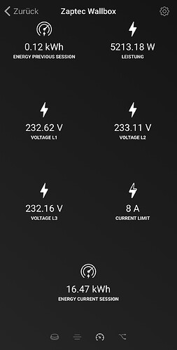

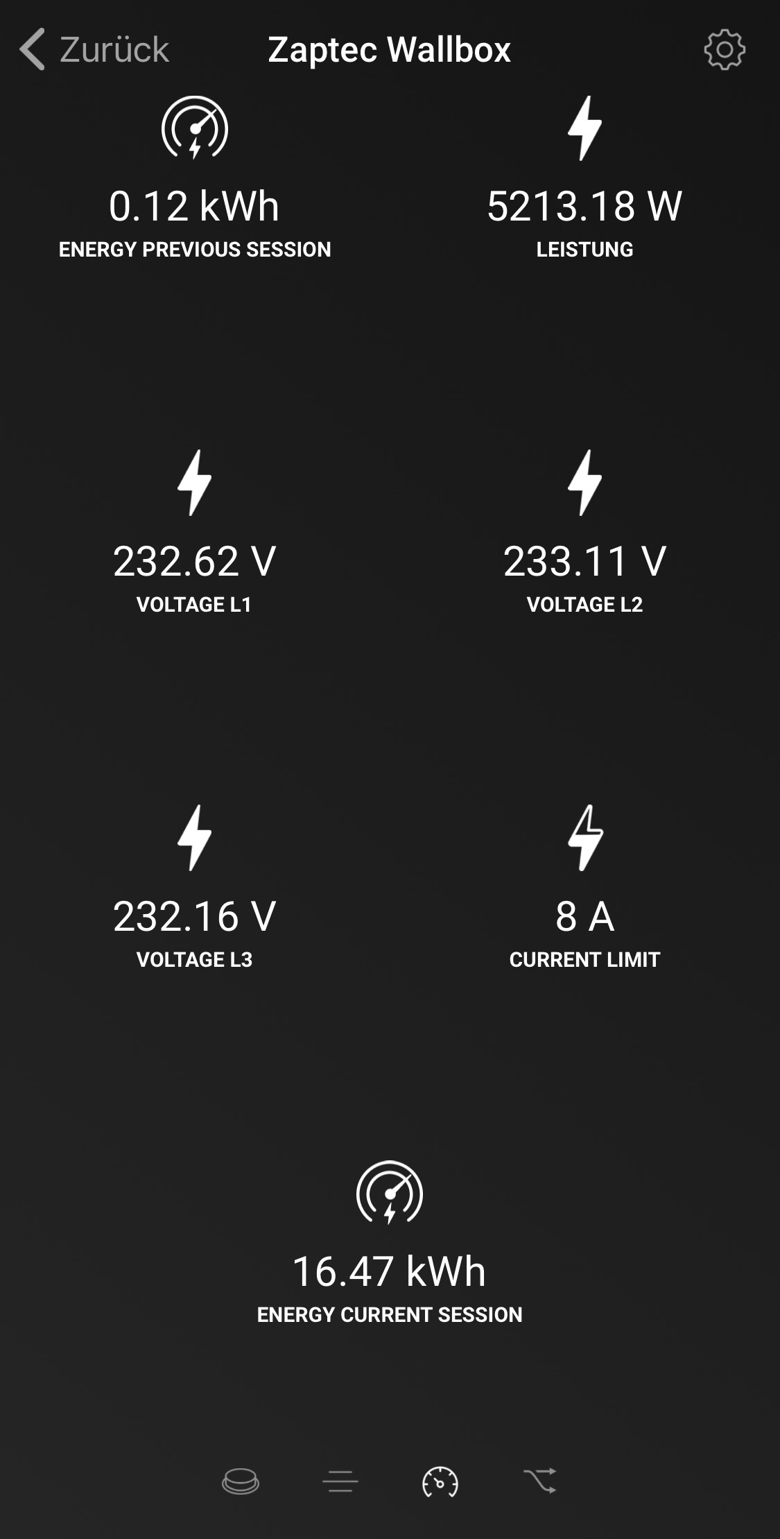

It seems, that the refreshing of the values is still not that reliable. I did a 22.5 kWh charge tonight. (see Zaptec printscreen) The Homey app stopped refreshing the values at 16.47 kWh and has not recognized, that the charging is done. It has not changed to Charging is finished and all values showing an ongoing charging. I had to disconnect the car until it refreshed the value.
I had a short power failure this night where the Homey was restarted, after that the Zaptec app was not operational. I will make new tests to verify the behavior to power toggle the Homey.
I have seen this a couple of times where the app is un-operational and might be addressed to a re-connection strategy @pwad ?
After restarting the app manually solves the problem!
