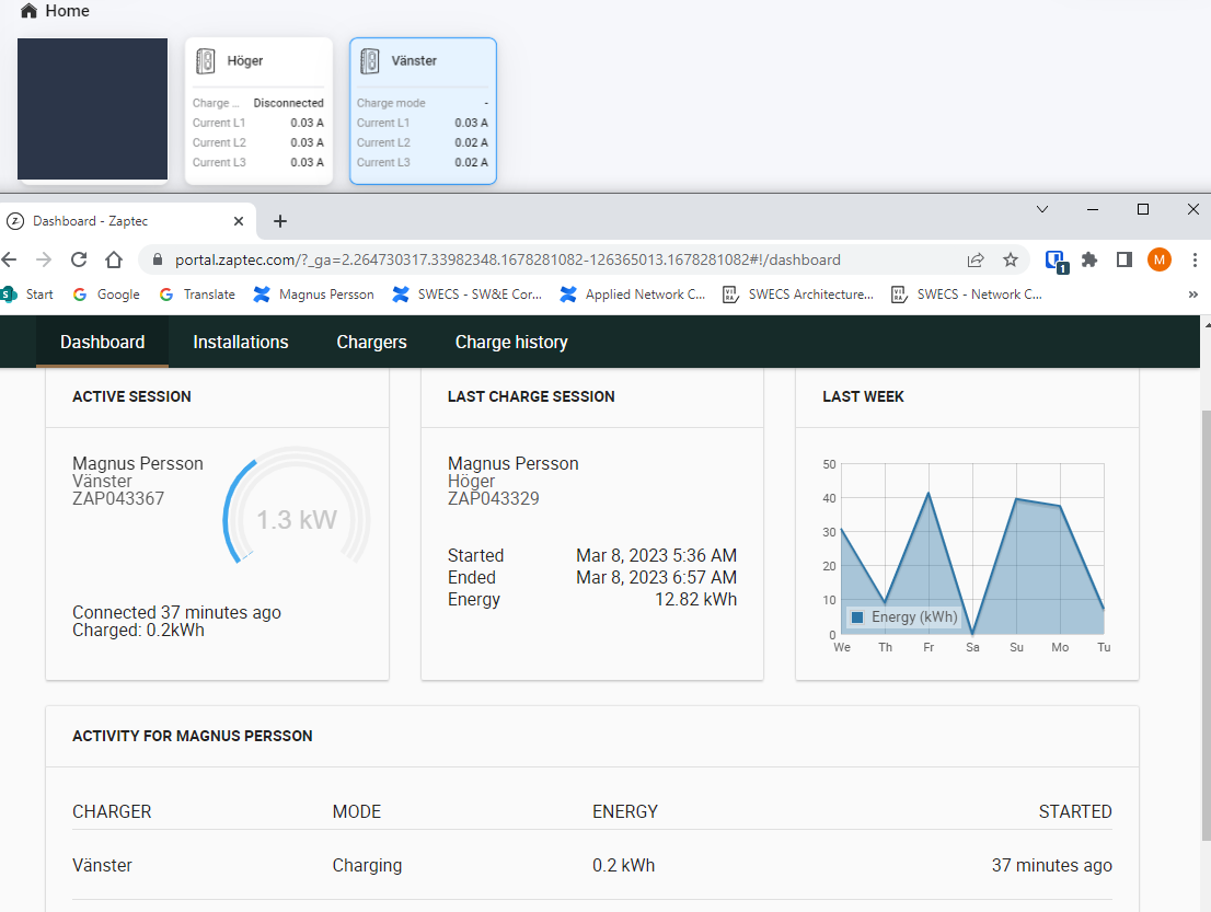

  • Two zaptec chargers (Left & Right)
I managed to start/stop the charger using the Homey device - Great!
The status in the Homey device is not in sync with the Zaptec portal i.e. reality. See picture where Left (VĂ€nster) is in state Charging where the Homey Device status is not updated and in sync!
EDIT: It seems after a while (>15min) the status is updated!
