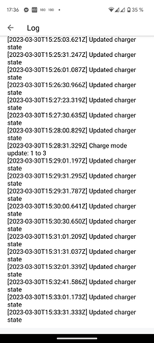

Did you get any entries in the debug log, visible in device settings? If so, can you paste it here?
It will rather quickly be overwritten in the log. I would need the log from about a minute or two after you tried to start charging (and it failed).

@pwad
Log is quiet unspectacular:
[2023-05-02T20:09:52.735Z] Updated available current
Just to clarify and to prevent missunderstanding: If I set to 0A, my Zaptec Wallbox does the right thing: It sets the current level to 0A. The only error is the value displayed in the app that shows 16A even if the Zaptec Box is set to 0A.
