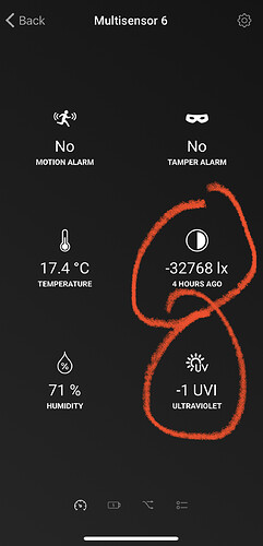

Hello.
I bought this sensors and I’ve noticed that the UV and luminous value don’t change…
What an I doing wrong? How do I use that ?

Hello.

Had that too in the past, in my case something went wrong while pairing the device. After I removed it and added it again the problem was solved.
I did pair and unpaired multiple times and same results…
Did you remove it by just unpairing it with a reset from the device? Or proper unpair via the Homey menu’s and got a conformation?
And did you perform an extra factory reset of the device between the unpairing and pairing?
Did you do this very close to Homey? < 10 cm.
Hi ,
I will try to do this multiple times and let’s see ,
Yes, I was very close to the homey hub .
I did unpaired via the homey hub and also reset the sensor itself…
Did you also try to include the Sensor unsecure?
Please explain…
I think it’s a problem with homey v5
During pairing you get the option to pair secure or unsecure. I had to pair and remove the device like four or five times before all sensors would behave normally. I choose the unsecure method because of all obvious reasons.
I didn’t see any option to pair unsecured…
Your completely right… 🤦🏽🤦🏽🤦🏽
It’s working but still the luminance get updated once and when I cover it or put more light it’s not getting updated…
Have you checked the advanced parameters about reporting intervals?
