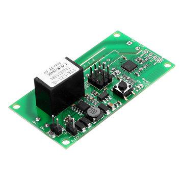

Otherwise, if The USB port is powerful enough, you could use a boost converter to get 12 volts from 5 volts and so be able to use a 12 Volts device .
can also be an alternative, probably you need to change the firmware into Tasmota.
