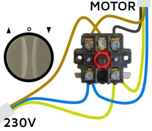

I am looking to integrate my rolling shutters in Homey. I already have motor controlled rolling shutters, so I do not want to replace these motors.
The shutters currently work with these switches:
Shopping online, I found the Qubino ZMNHCD1, but this module is not (yet) supported by the Qubino app.
Does anyone have a solution for this? I have motors that run on 230v and I prefer using Zwave Plus devices.
Thanks in advance.
