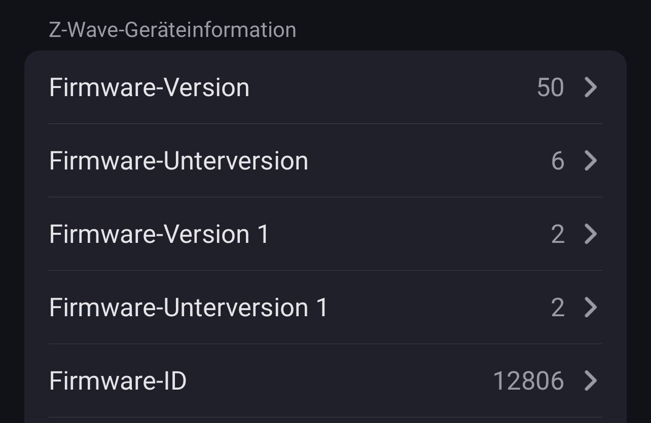

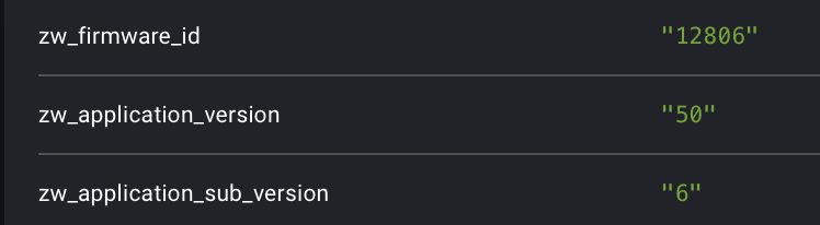

You can find the FW version in Developer Tools → Devices:
Or, if you’re already on Homey FW v10.0.8, in the advanced settings of the device:
However, it could be that no information is available. According to my observations, Athom added the possibility of displaying the FW data of a Z-Wave devices with a Homey FW update, which was released about 1 - 1,5 years ago. All devices that were added before this Homey FW update don’t show any information.
