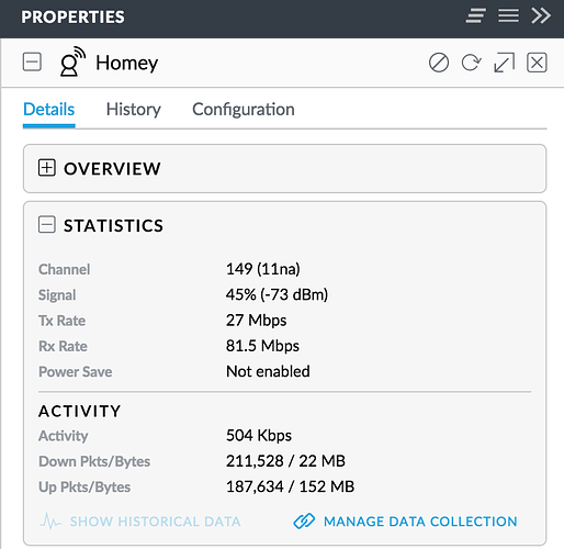

I have my Homey placed around 1m from my WiFi AP. My WiFi system is showing its connection at around 50% signal strength, yet many other devices around my house further away are showing 90% +.
If anything the Homey should have the strongest connection.
Is there an issue with the Homey WiFi ? its connected on the 5Ghz band, my WiFi is Unifi Pro’s.
I do have band-steering turned on, would that make a difference if the Homey prefers / has stronger 2.4 Ghz Wifi support ?
Homey doesn’t support 5ghz wifi at all, it is only 2.4ghz.
Its certainly showing as connected on channel 149, which is 5Ghz
Did Athom silently started delivering newer hardware with 5 Ghz support?

@DaneedeKruyff No, we do not ship Homeys with 5 GHz Wi-Fi. The Wi-Fi dialog is wrong.

Just to update everyone, I made a 2.4Ghz only network and reconnected my Homey to that, and its now showing on the 2.4Ghz channels, and 99% signal strength instead of the 45% on the 5Ghz bands !!
As Emile stated before. 5ghz is not supported. Great to hear you’re 2.4 has a good connection :blush:
