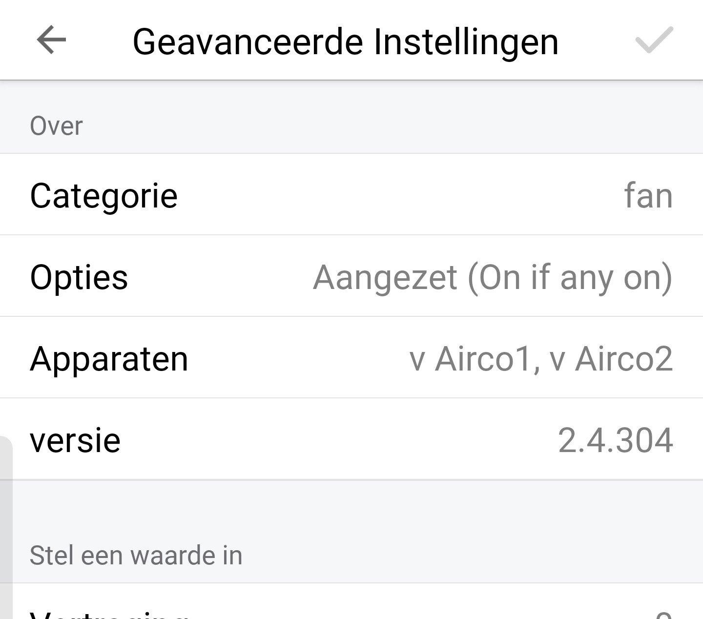

With the group app you can add an airco group device. I used device type “fan” for this.
This way you can control all airco’s together (switch all on at once, and switch any airco which is on to off).
AND, it can show the status:
If any airco is on, then the device tile is active.
If all airco’s are off, the device tile is inactive.
It responds to the on/off state of your individual airco’s.
No flow needed.
Setting of airco group device (ON if any on)

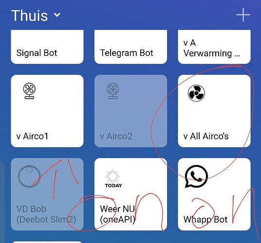

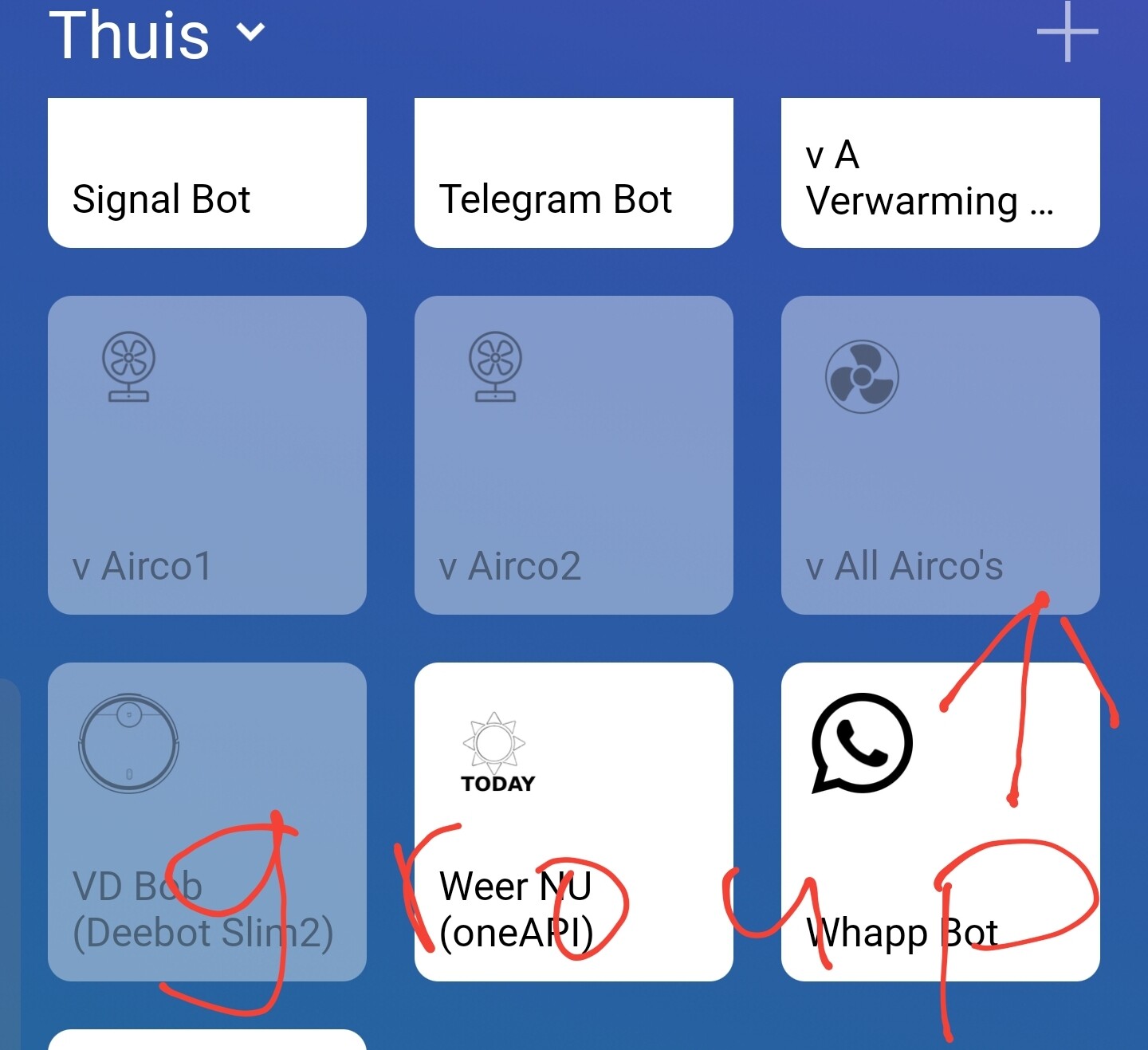

Device tiles view, the group device is on the right.
State shown: The two airco devices are off, so the group device is also off.
If one (or more) airco device is switched on, the group device also gets the ON state:
I hope this gets you going!

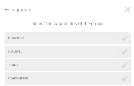

Hi Peter, thanks for your reply!
This way was the first I tried, but when I select the “fan” type in app, it gives me the following capabilities to choose:
FAN
CAPABILITY
If I select “TURNED ON”, the App shows me some of my devices but the air con’s.
