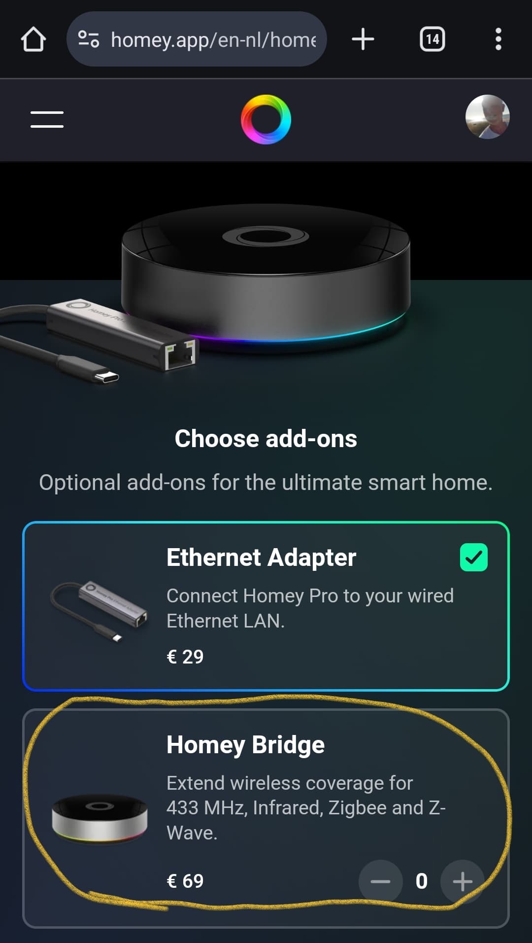

I was considering buying a Homey bridge to cover my garage which is 20 m away from my Homey Pro, too far for zigbee devices to reach but, if I understand correctly, the bridge doesn’t deserve its name since it doesn’t “bridge” zigbee and zwave signals from Homey Pro but serves as another repeater.
So, why would anyone buy a Homey Bridge ? For what use ?
