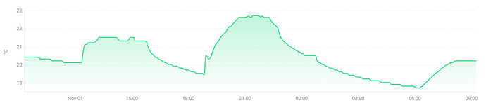

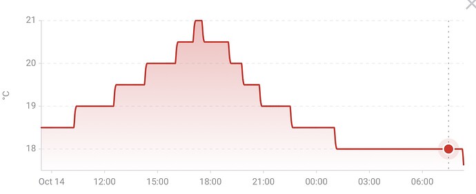

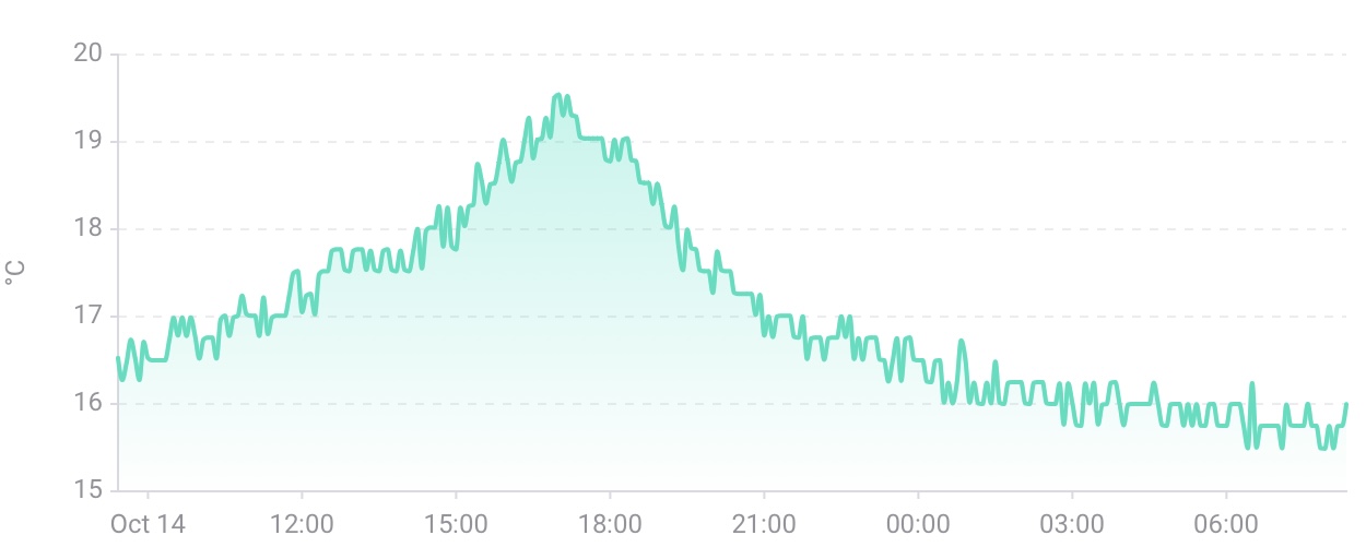

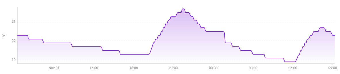

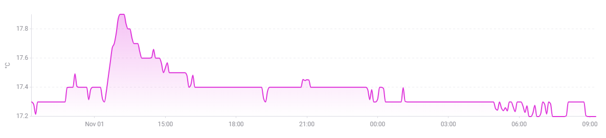

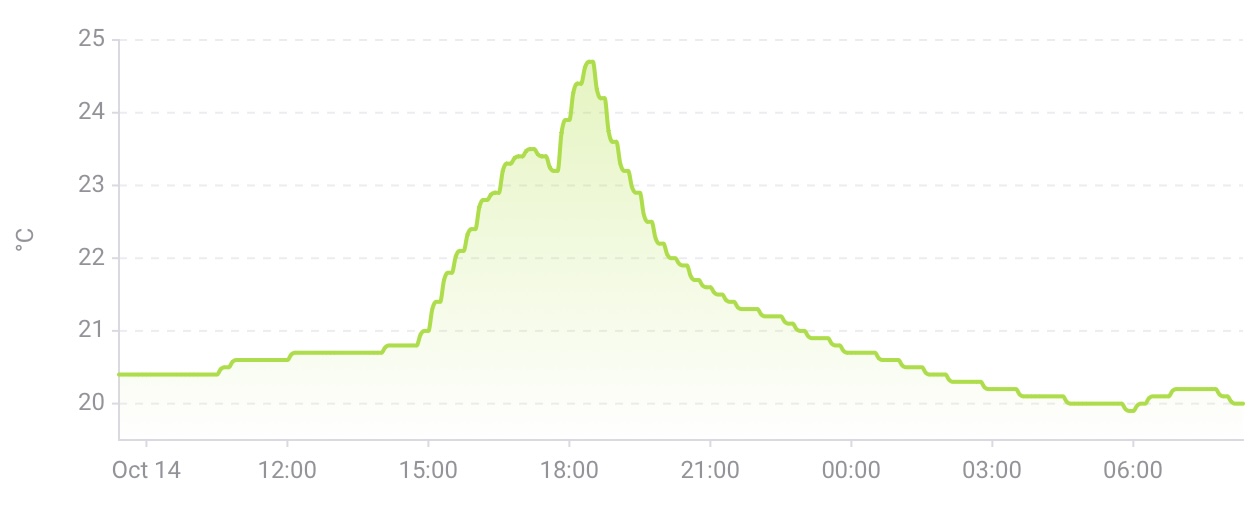

Many homey-connected devices have temperature sensors, so one can quickly assemble a good idea about the temperature across the house. However, I found out there are significant differences to the usability to put different sensors to control flows (accuracy and precision of readout). The three images attached show graphs of the temperature profile in different rooms (with slightly different temperatures but a similar peak) during a sunny episode. Our netatmo room thermostat shows a precision of 0.1 degree steps, and appears to be very stable, it is accurate. The netatmo radiator valve is also very stable, but only shows 0.5 degree increments, a relatively low precision. The third graph is from a Hue presence sensor, which presents values in 2 decimal digits (very high precision) but appears to make roughly 0,25 degree steps and the readings are noisy (low accuracy).

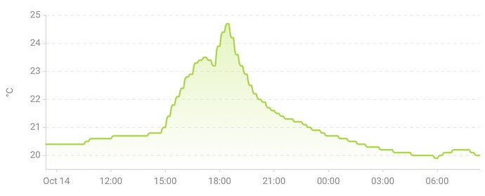

@rwwh Here are some devices that I’m using. Similar to you they are in different rooms and their readings differs from device to device. Keep in minds that Homey by itself also average the numbers in their Insights for older data.
Switchbot Hub 2 and SwitchBot Indoor/Outdoor Thermo-Hygrometer are both similar to your Netatmo thermostatic valves, a bit better but they increment by 0.2:
This is an Aeotec multipurpose-sensor ( Multipurpose Sensor - Aeotec):
This is Aeotec Water Leak Sensor ( Water Leak Sensor - Aeotec):
This is a Dyson Fan:
This is the AirGradient One Indoor (I think the deep is caused by some sort of self-calibration, I never bother checking to be fair):

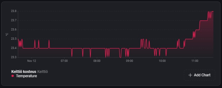

Just checked my Frient temp and humidity sensor and it seems to measure with 0,1 degree interval.
