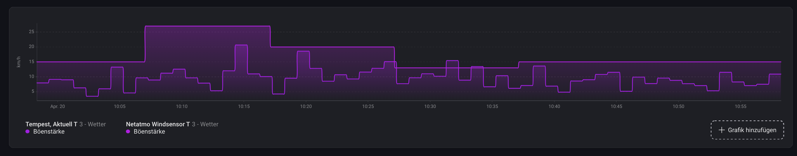

This is the comparison of the gust strength between Netatmo (10 minute interval) and the Tempest Weatherflow weather station (ca. 1 minute interval):
I’m not completely sure, but I think that the intervals were shorter for both weather stations in the past, e.g. 5 minutes for the Netatmo weather station.
I guess that all weather stations that communicate via API have a certain interval of several seconds, but probably more like minutes.
