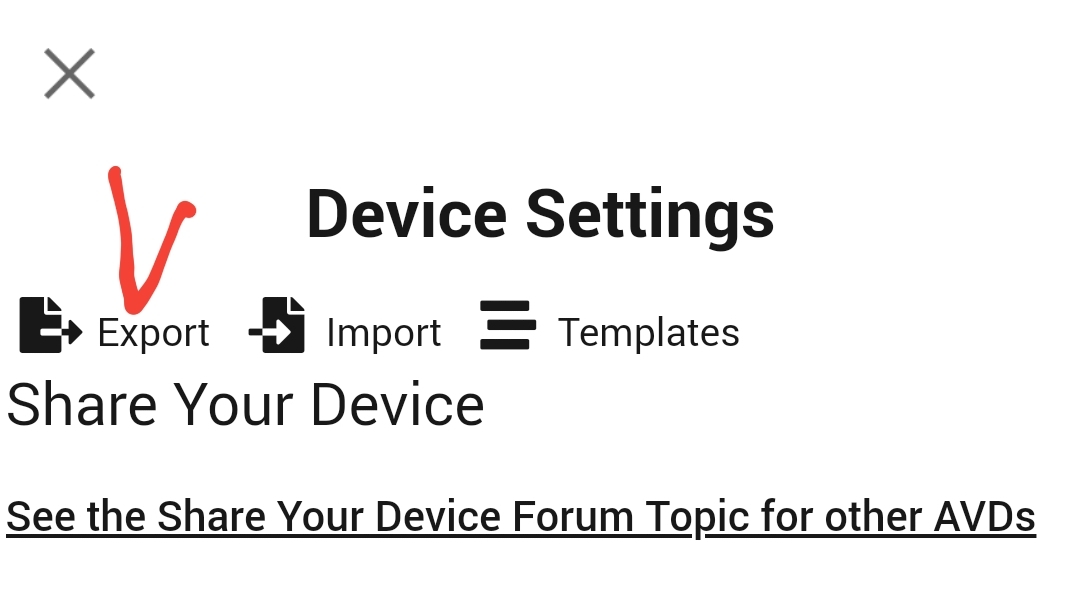

You can export a functional AVD to code, save the code as a plain text file (the code is called TEF: The Exchanger File)
Go to Maintenance > Try to Repair
Then you’ll see this
Untick the “Include flows” box
When you add a new AVD, you can choose ''importing a TEF" and just paste the code and press “Read Device”
Now you (should) have a clone
