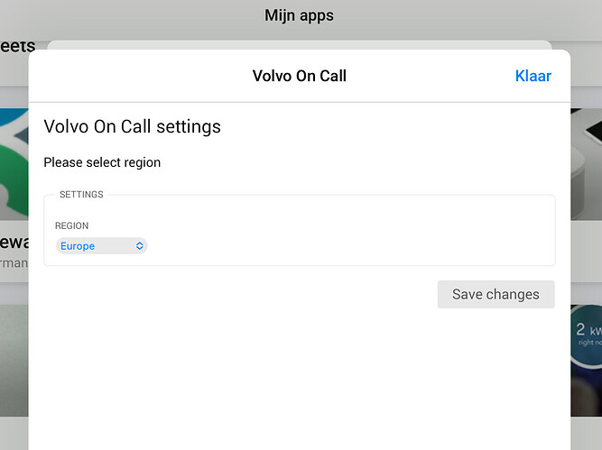

I saw this app appear and was wondering if this app still works?
I have a Volvo XC60 MY23 with a Volvo ID and after installing the app on my Homey pro 2016 I only see a screen where I can select my region.

It would be very valuable if a reference is given HOW to log in to the “Homey VoC app”. With a link to a thread where some things are discussed off-topic about an old API that no longer works, you help someone more “from the frying pan into the fire”.
I have completely browsed through the complete discussion, more than 45 minutes later, and I still don’t know how to log in. I have chosen Homey because this device was more user-friendly than Home Assist but …
It is described in the 1st sentences of that thread
If you can tell us which steps you did and where you got stuck we can help you

Thnx, it works, but it wasn’t easy. Your last post was a good guide for me. To create a VCC API-key I used the manual of Daniel Roos.
https://www.roosdaniel.com/volvo-api-data/
Please note, change V1 into V2 here of the mentioned URL.
And it wasn’t immediately clear to me that the VOC app in Homey is the interface and that you have to create a vehicle as a device. (which makes sense :wink::+1:)
