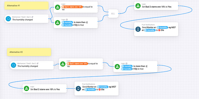

Just a question when design flows.
The two alternatives in my example do the same thing.
However, which one of this examples is the best one when thinking of use of resources?
Is it better to make use of the ALL function or is the “in line” better?
The difference between these two is not present in this small flow, but when more and bigger flow, there could be an difference.
Any thoughts?
(This example is for starting the ventilation in my bathroom.
It reads the humidity in the bathroom and compare it to an reference outside the bathroom.
If the humidity in the bathroom is 10% more than the reference outside the bathroom, then the ventilation should start.
The ventilation is supposed to run until the humidity is reduced to around 5% or less, and then run further more with an delay of 10 minutes.
The complete flow is not finished yet… )
You are right they are both equal. So it is a question of readability.
I just have one question: If humidity and humidity are the same variable or property this part will never be true. Probably you should rename one or, if not possible, add a description field to know about it later - or not to confuse a reader here. :wink:
In #1 the calculation is always done. That is for me a kind of waist of time/energy.
So I would prefer #2. Also for clarity in reading the flow.
Thanks.
They are two separate sensors.
But I agree, I have to rename the sensor to avoid confusion.

The only thing I know that when you hop above a tag you see or a value (from the last flow action) or the name of the item.
Yup, in Adv. flow hovering is the only quick way to discover the device the tag belongs to in existing flowcards.
And additional, no, you can’t edit the tag names unfortunately.
For example, one can have 20 sensors which have a Humidity capability, and the tags just are [Humidity] for each and everyone.
I think this an annoying side of Homey flows, I’d like to be able to see which device the tag is from right away, especially in the bigger complex flows.
I use the ‘Note’ option in those cases, I just write down what is what for particular flowcards…
