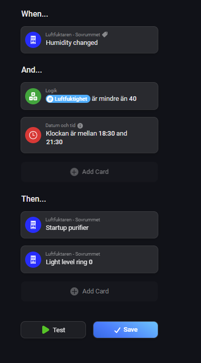

I’ve tried running it but nothing happens I’m afraid. The logiq tag is humidity on the built-in sensor on the humidifier itself.

Another thing, if this flow started to work, wouldn’t it then trigger everytime a change in humidity was registered? It would be quite natural that the humidity increases when the humidifier is turned on, I don’t want it to run more than once each session.
It triggers every time the humidity changes and the time is between 18.30 and 21.30 and humidity is below 40.

Yes, humidity is still reported while the humudifier is in standby. Can’t figure out why flow doesn’t seem to work!?
Is it the right tag? The tag from the purifier and not the tag from Homeystandard (weather).

Does it have anything to do with the triggers value not correlating to the logiq tag value?

Have you tried the flow with the local tag?
There is only that one local tag that I attached in previous image, #value that is available, not surprisingly it doesn’t do anything.
