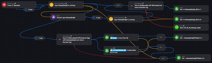

Came across this topic when looking for something else…
Tried to use sysinternals originally, but wanted to have troubled App-CPUvalue instead (I have rather heavy HomeyScrip every 15min).
so created this (propably ugly but working code):
// Fetch current CPU load of App
const targetApp = args[0]; // Get the target app from the arguments
const appsInfo = await Homey.apps.getApps();
for (let entry of Object.values(appsInfo)) {
let appName = entry.name;
if (appName !== targetApp) {
continue; // Skip this iteration if the app name doesn’t match
// If the app name matches, get CPU and memory usage
let cpuLoad = entry.usage.cpu; // Access the CPU usage
let memUsage = entry.usage.mem; // Access the memory usage
console.log(App: ${appName}, CPU Load: ${cpuLoad}, Memory Usage: ${memUsage});
return cpuLoad; // Return the CPU load if found
// If no app matches the target app, return -1 to indicate no match
return -1;
Then flows like this:
And
---- update —
Improved upper part of flow when tuned some low-prio flows to run even faster (now also 5sec
(+ 3sec delay) level wo issue) as blocking to be too slow to stop…
Small explanation:
  • HomeyScript as before
  • “10.10…” is flow where (all of my) lodash functions are introduced like in example
  • “testing only…” card is testing just one of them to verify if passes (as if HomeyScript taken down they are gone as well)
  • Any Low-prio flow can be (safely) started with e.g. (running check just to double sure if wished):

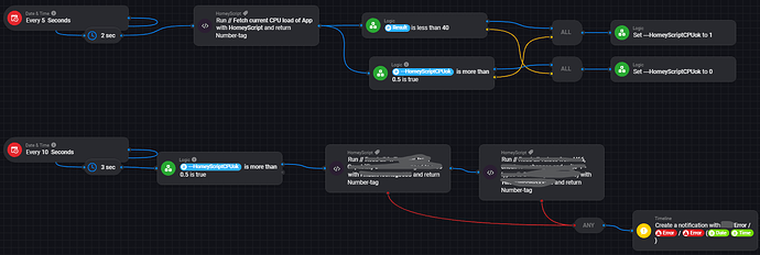

And updated insights for the same - blocking shorter than before but yet more effective:
