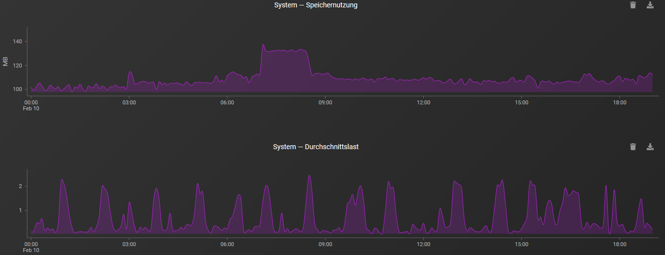

I have periodical peaks in CPU load over 200%:
Does anyone know how to find the causing app or part of homey system?
All apps in Insights have 0,00% CPU load.
So my question: Were does this load come from?
Exists a possibility to get the system load of system parts like flows, ZigBee, Z-Wave, perhaps somewhere in Developer site?
