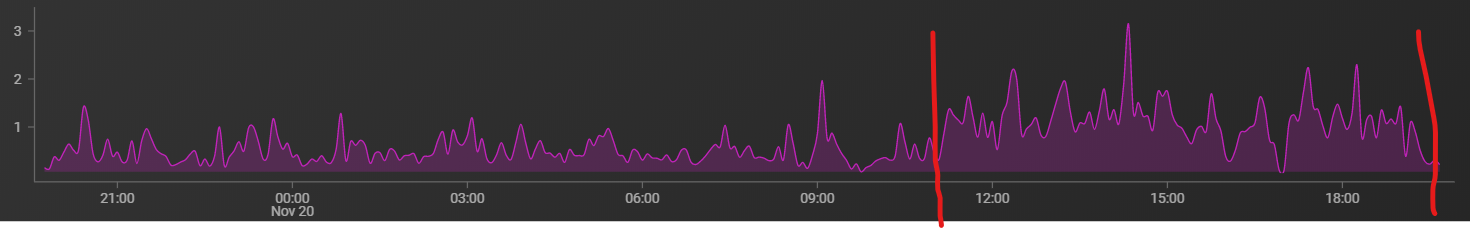

This morning I noticed my Homey was very unresponsive, I checked the load and it was through the roof (always over 1, sometimes up to 3).
After some troubleshooting I found the problem, a very simple flow:
How can this simple flow cause such a high load?
Red lines is where I created the flow and where I disabled it

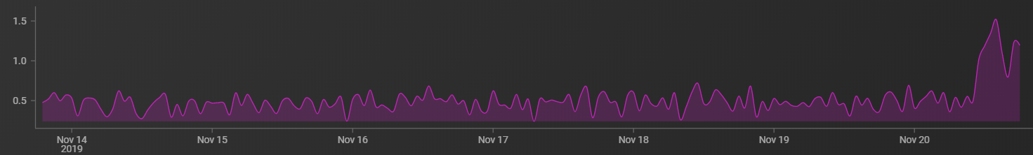

[edit]
This shows the problem more clearly:
What type of device is the socket?
Neo. Which I have been using for a year already in a flow for that pump.
But… it gets weirder.
I enabled the flow again to check what would happen. It didn’t run yet since it starts at midnight but for now there is no higher load.
I also noticed this when i enabled memory use together with the system load:
How can a flow like this cause such a difference in memory usage?
Not entirely sure but what I do know is that the “turn off after … minutes” is prone to causing a CPU spike. Hence I transferred all flows with that card to countdown.

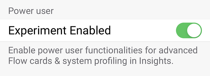

Maybe a dumb question, but how to activate the CPU-load graph in Insights?
I only have the energy options under Homey…
Go to settings/experiments.
