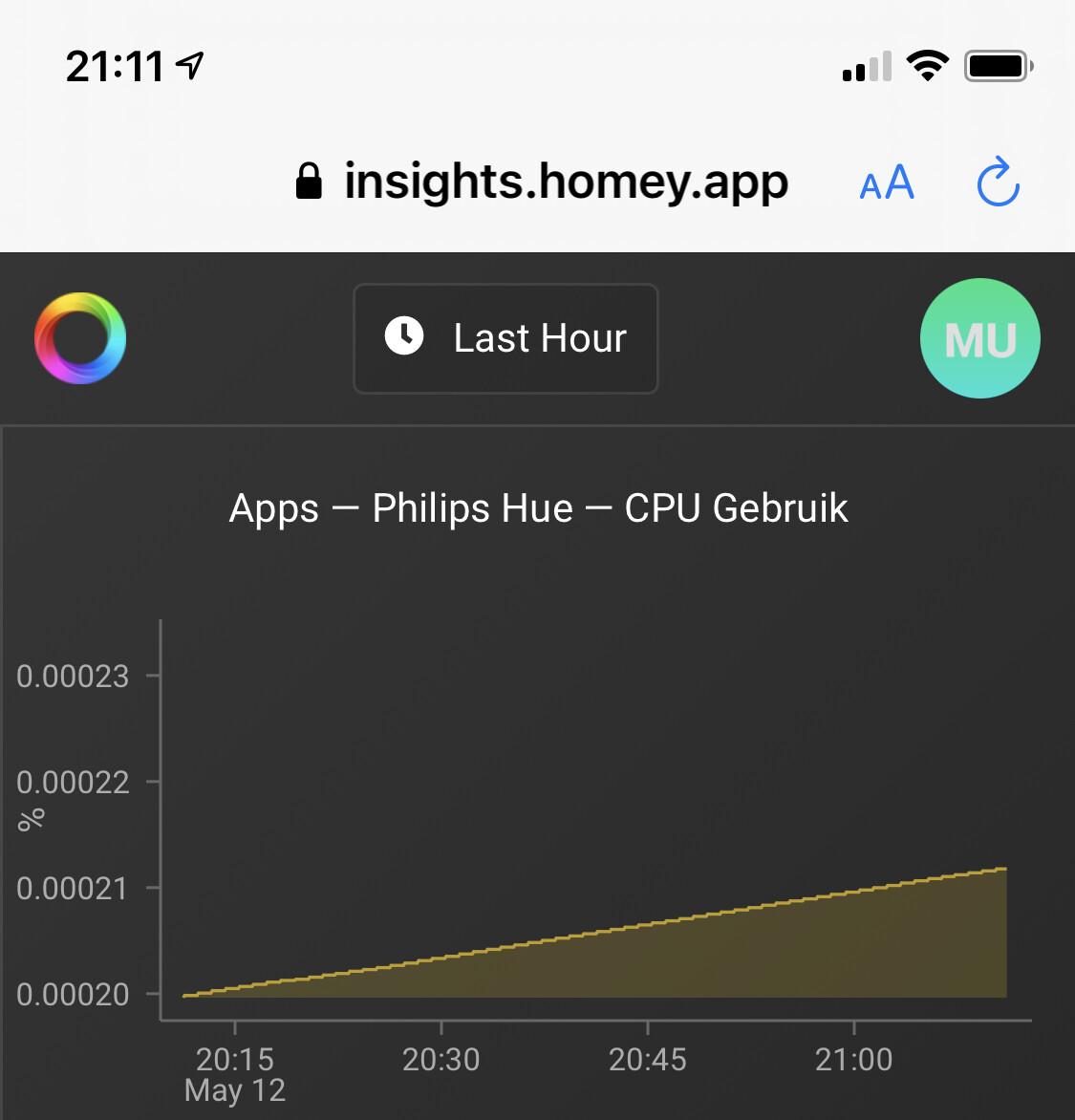

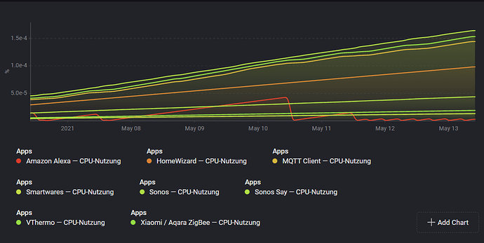

Good idea, I think the easiest way is to dragndrop all app cpu loads in one graph in the web app insights:
The picture here should just be an example how it looks, not a problem description!
Looks like amazon was way more CPU hungry for a while (steeper line) but now not any longer. I do think you should zoom in on time level more, because the day averages will hide the peaks.
I’m sorry Edwin, I forgot to explain that the picture should be just an example how it looks, not a problem description!
But regarding to your good eye and your hint, I changed the flow handling with the Alexa app (automatic deactivation/activation to keep Homey connected to Alexa) a few days ago. Maybe there is also a positive result to the cpu consumption.
