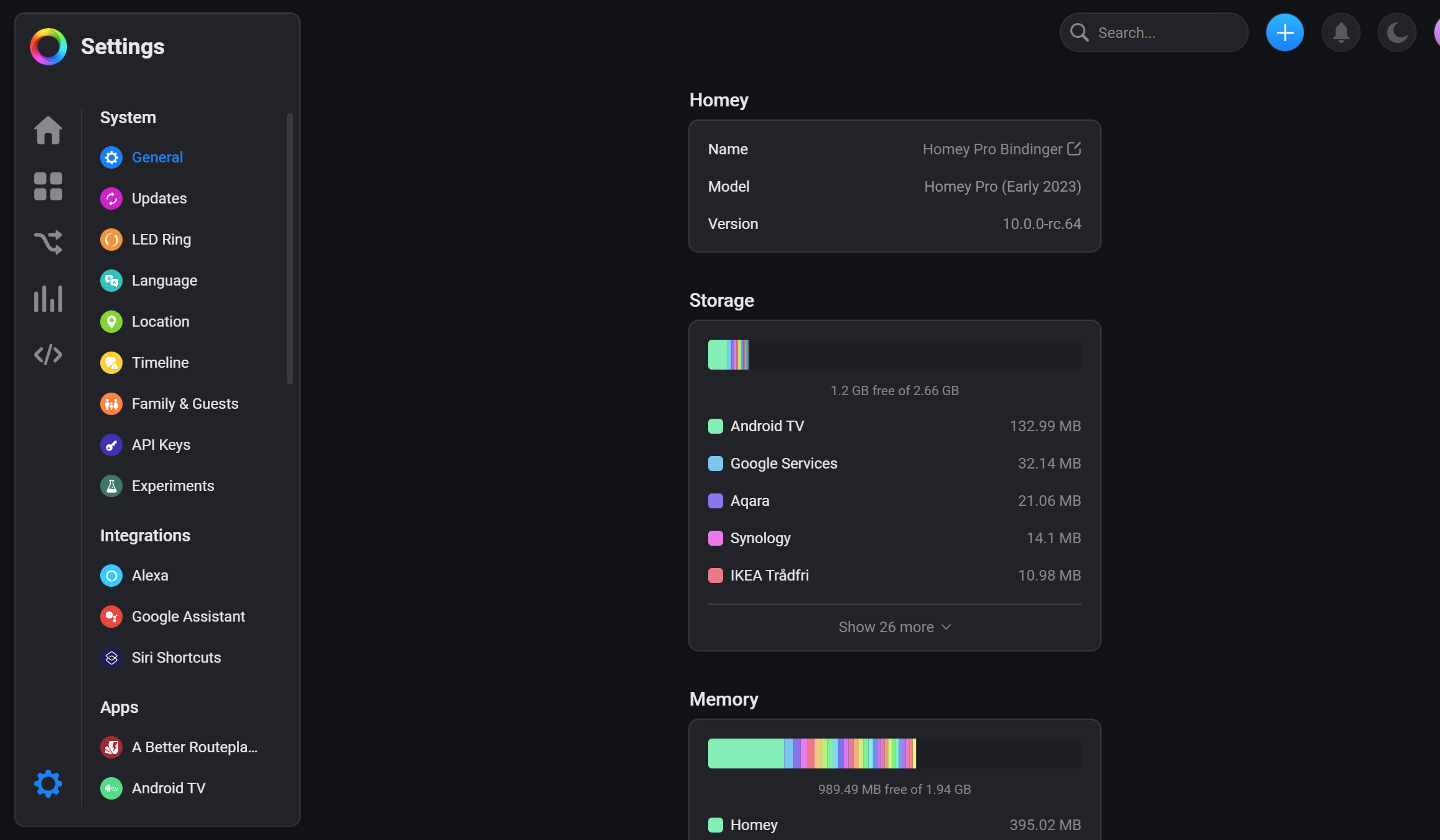

Hello.
I just bought a Homey pro 2023, and you are completely new to the Homey world
It has been set up as it should and there were no problems.
But. when I look under “update” I can see that there is a framiware update. my homy pro is running right now ver. 10.0.0-rc.64 and the new firmware er ver. 10.0.6. I have now downloaded and installed this update several times without any problems, except that every time my Homry pro has restarted after the update, it shows that the firmware is stable. 10.0.0-rc.64 is on the device, and that there is an update to the ver. 10.0.6 must be downloaded and installed.
what do i do
