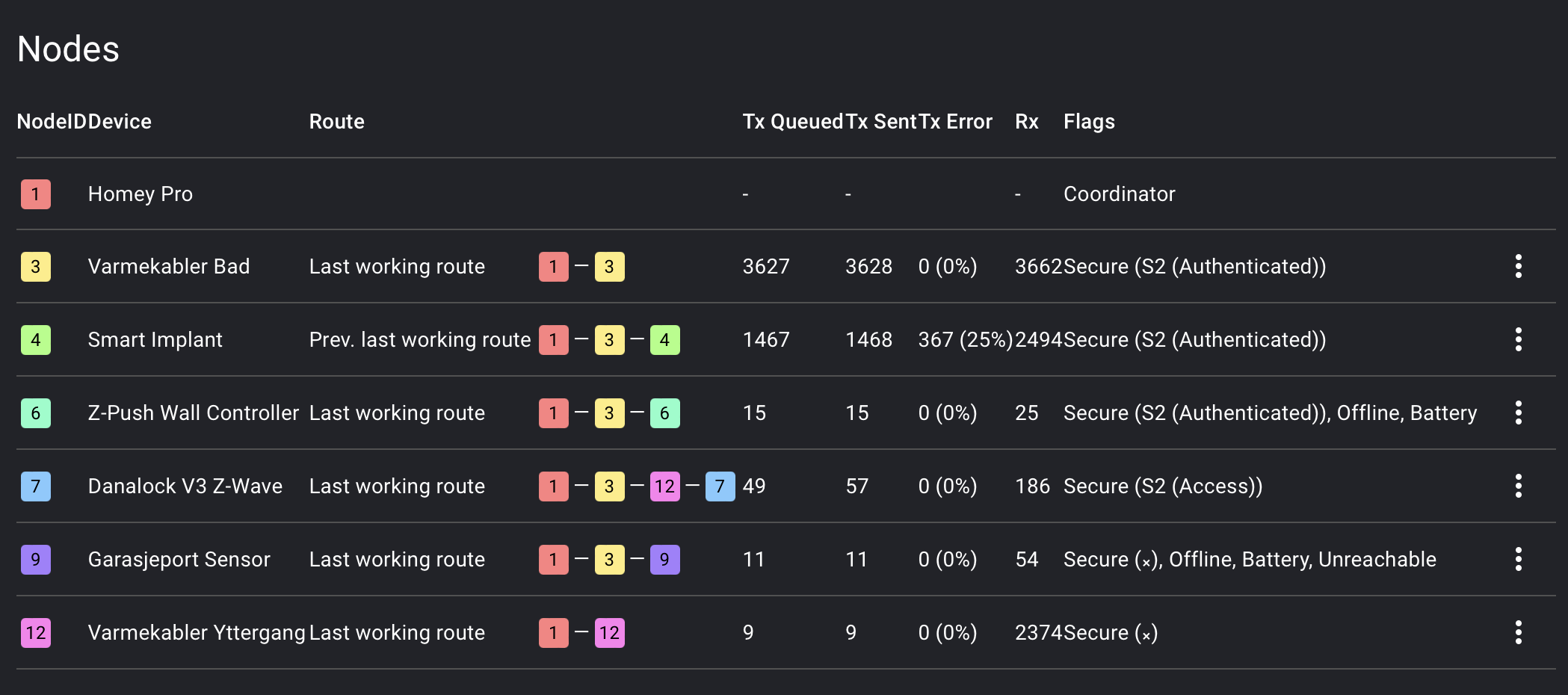

I have a fibaro smart implant connected to my garage door. It worked well for about 4 weeks, but the last couple of days it has become very unstable. After 12 - 24 hours it stops responding, and the only thing that seems to work is to unplug it and “reboot” it. I have tried to both test and heal it in the tools page.
Since it is in my garage I though that it might be a signal issue, but I have another battery driven sensor (“Garasjeport sensor”) there which is farther away and always responding. Anbody who have had the same issues, who might know a solution here?

The smart implant is connected to 230v power supply. But it might be as you say, that the smart implant have a lower range than the door/window sensor that runs on battery.
Oh okay. If it’s mains powered it is indeed odd that it worked fine for about 4 weeks and it suddenly changed. But an extra router between Homey and the Fibaro surely might help!
It’s a pity we cannot view signal strength :hugs:
