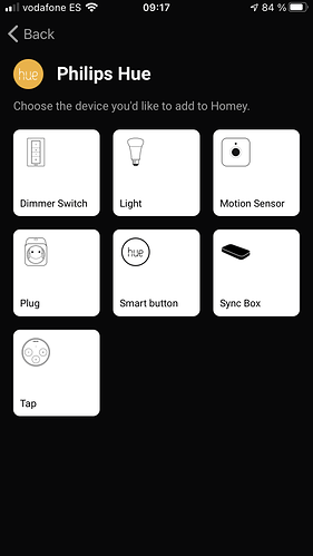

I am having a similar problem and wondered if anyone could help.
I have hue lights setup via a bridge. Since we moved house I have tried to setup the system again, due to some teething problems I re-setted my Homey and removed all devices, apps etc to start from fresh.
I now cannot “find” any hue devices. I have followed the thread above but it does not seem to help.
When I go to: Add Device > Philips Hue > Light > Connect
I get the message “No new devices have been found”
The hue lights work fine with their switches and ios hue app.
Any suggestions? Thanks in advance.
Stupid question, but did you connect the Hue bridge to Homey by pressing the round button at the Hue Bridge?
Not a stupid question at all actually.
The answer WAS no, I hadn’t tried this.
However I have subsequently tried and am having no luck. I had been expecting that when I go to Add Device > Hue, one of the options would be the bridge, but I don’t see this. I am probably missing a very simple step, but can someone walk me through step by step (or point me in the right direction)
Thanks (screenshot below)
