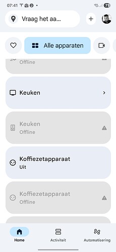

However, if I go into the Google Home app it shows something like this:
In this picture “Keuken” is directly linked via the Google account and the bottom “Keuken” is linked through Homey and not controllable.
The same goes for “Koffiezetapparaat”. It is one smart plug and the top item is connected through Tuya and I can control it. The bottom “Koffiezetapparaat” is linked through Homey and cannot be controlled.

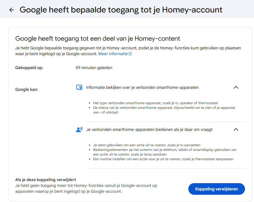

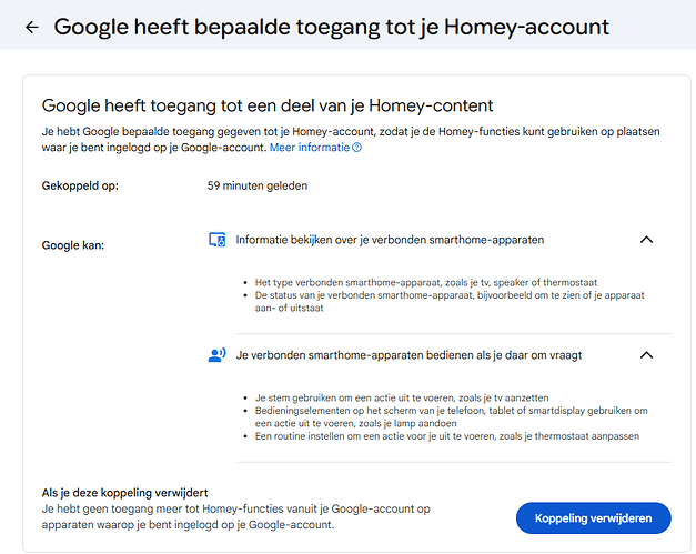

Tried to disconnect Homey from this screen and even disconnecting the service errors out stating it cannot reach Homey.
However it is removed here:
Edit: After hitting “Homey ontkoppelen” the device is still visible as offline in Google Home, but now “Homey Ontkoppelen” is greyed out
