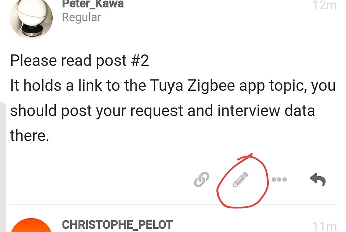

Can someone move my post if you please?
It’s quite easy, just edit your post by hitting the pencil
Copy everything
Paste into new post in Tuya topic
