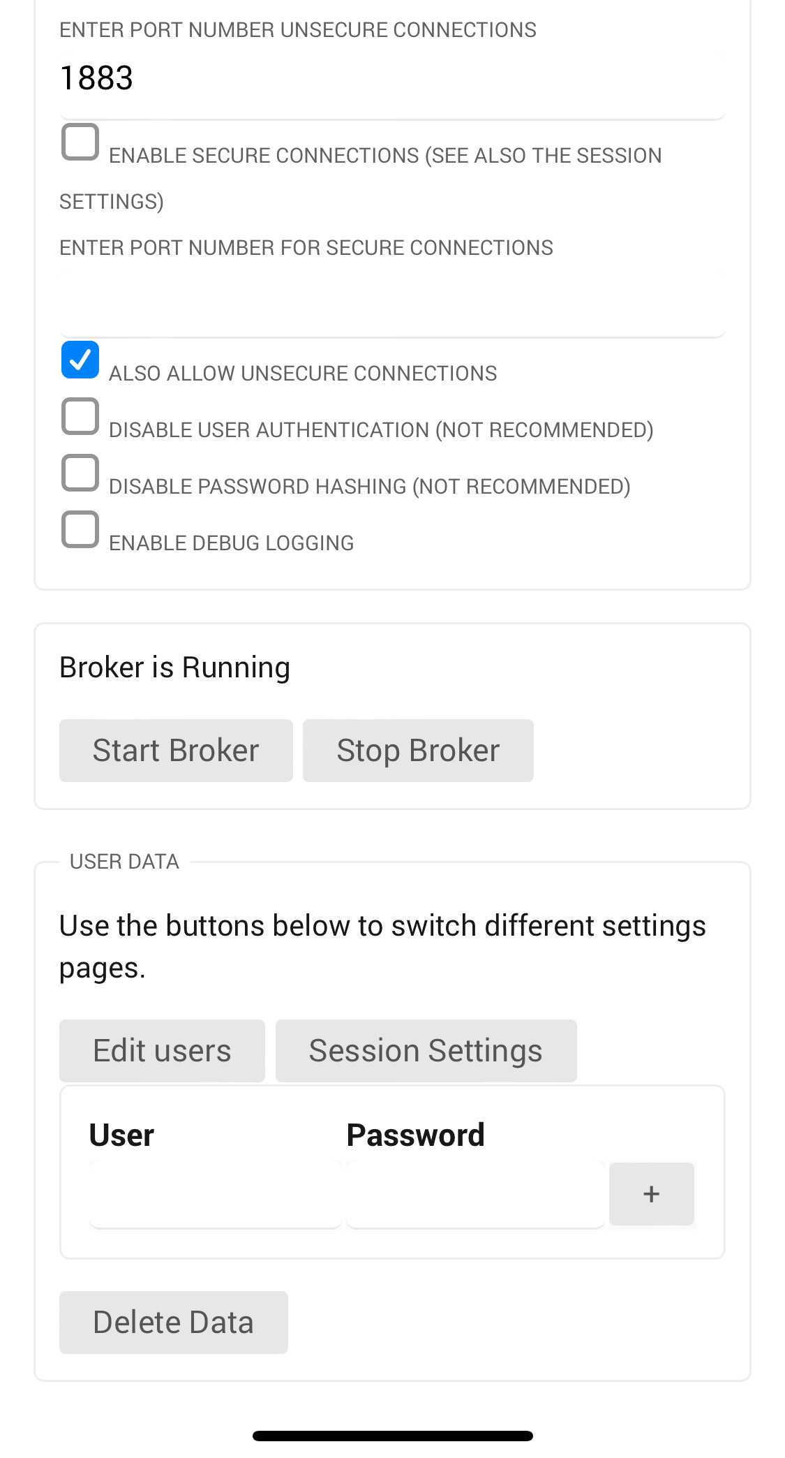

Hi everbody,
I got my awtrix light yesterday and am running into two issues:
  1. I am struggeling to get MQTT messages to the device…
The ip-Adresses are correct, to funny things such as secure connections at this point… (as far as I can see)…

in your first picture is the IP address for the mqtt broker not correct - last segment is missing
It’s blanked.
Sorry, I blanked it - out reads 192.168.1.200… in all app configurations where necessary…
And: it makes no difference if I have the pre-installed apps such as weather, battery status etc. activated or not.
Both the client and the broker are running on the homey. I have changed the IP address information in the client to localhost, and now the log no longer shows “ECONNREFUSED 192.168.1.200:1883”, but actually seems to connect to the broker…
Broker seems to “deliver the info”, i. e. log shows “packet published homey _82818d92”…
… but still no notification on the awtrix…
What I realized is that in my flow
the Client icon left to the command has changed from a mosquito into a gear wheel.
Does this suggest a problem?
Got it…got confused with the ip addresses of broker, client and awtrix…
thanks anyhow…
