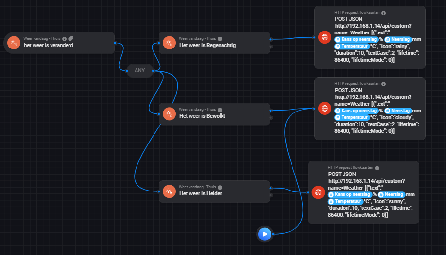

I’m adding custom apps in an Advanced Flow to do the following:
  • display PM2.5 level
  • display current indoor temperature
  • display current weather
  • display moon standings (although I’m missing some input data for this)
This topic is interesting:
I think it’s possible to replicate the same logic with advanced flows.
Okay I got a lot of the stuff working, with custom apps now… however, the icon functionality doesn’t seem to function yet in the test version, the list of icons doesn’t update currently:
So I made a small workaround which does the trick for now:
Now it’s working. Not sure if I like the scrolling information… I might make a separate app for rain probabilty, rain level, etc.

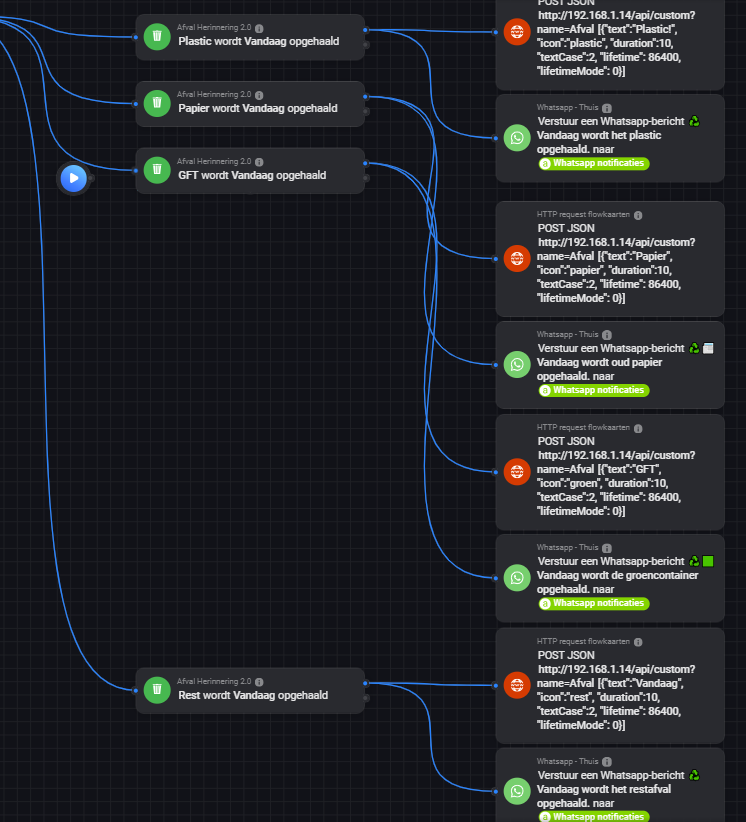

Adding a trash indicator.
Edit:
I decided this can be done in a nicer way, and I let ChatGPT write a homeyscript for me. Note, this is still a work in progress.

trashLogic.js:
const createCustomApp = async (icon, text, rainbow, duration) => {
  await Homey.flow.runFlowCardAction({
    uri: 'homey:manager:logic',
    args: {
      method: 'post',
      url: 'http://192.168.1.14/api/custom?name=trash',
      headers: 'Content-Type: application/json',
      body: `{
        "icon": "${icon}",
        "text": "${text}",
        "rainbow": ${rainbow},
        "duration": ${duration}
// Check if today is a day for various trash pickups and create custom apps
const checkAndCreateTrashApps = async () => {
  const trashPickups = [
    { type: 'PAPIER', message: 'Papier', icon: 'papier' },
    { type: 'PMD', message: 'Plastic', icon: 'plastic' },
    { type: 'REST', message: 'Restafval', icon: 'rest' },
    { type: 'GFT', message: 'GFT', icon: 'groen' },
  for (const trash of trashPickups) {
    const { result: isTrashPickupDay } = await Homey.flow.runFlowCardCondition({
      uri: 'homey:app:com.trashchecker',
      args: {
        when: 'today',
        trash_type: trash.type,
    const whatsappRecipient = '<Whatsapp recipient>'; // Replace with the actual recipient
    if (isTrashPickupDay) {
      await createCustomApp(trash.icon, trash.message, false, 10);
      const whatsappMessage = `Afval aan de weg zetten: ${trash.message}`;
        uri: 'homey:device:<guid of whatsapp client app>',
        args: {
          recipient: whatsappRecipient,
          message: whatsappMessage,
// Execute the function to check and create trash apps
checkAndCreateTrashApps();

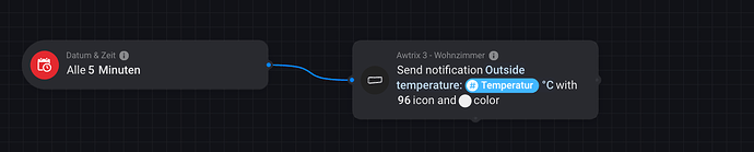

Good afternoon,
sorry if ths topic has been already described, is there a way to get temperature from Netatmo integrated into Homey and display on Awtrix also integrated into Homey?
Many thanks for your tips.
Best
J.
Of course, e.g. like this:
When…
– Every 5 minutes
Then…
– Send notification (free text + all tags/variables)
Gosh! Many thanks Dirk. I was so twisted today that I have omitted this… Thanks again!!
Or you can create app, that is in beta version, simply set app, and whenever temperature outside changes, it will update app itself. Advantage of this solution is, you see app during cycles of Awtrix.
