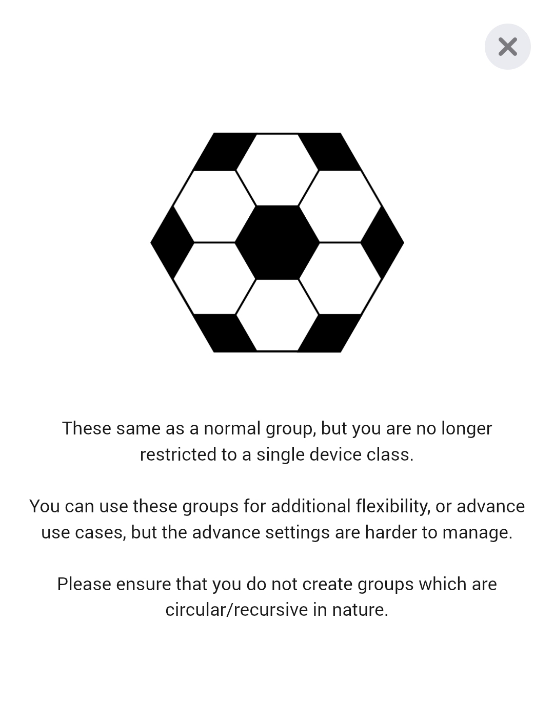

What’s the difference between a Light group and a United group? Is that something I can configure?
Best regards,
Patrick.
Hello Patrick,
No problem.
OK, so we can rule out individual device issues.
The descriptions are a bit hidden; after starting to add a United group for instance, a description is shown
I just coincidentally found the delay setting in this particular group type.
Maybe it’s present in other types as well, but not in the standard light group, which puzzles me.
