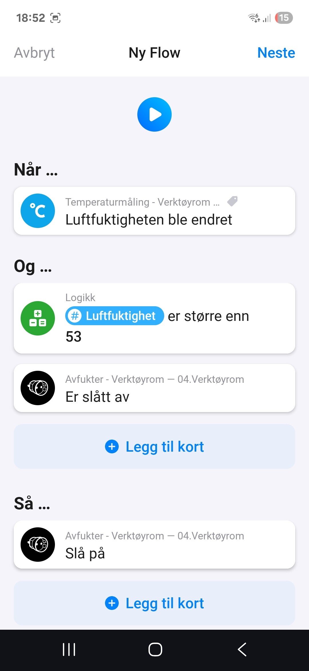

Why not just check if the humidifier is OFF with a AND, before you send the ON command together with the message? Then it can only send the message, if the new state of the humidifier is ON.
Something like this (Luftfuktighet is Humidity, Av is Off, På is On):
Havent thought about that. Thanks for your input. I’ll give it a try.
It took me a while because of the norwegian in your screenshot but i got it now.

  1. in the first flow for turning the smart plug on and pushing the message, add a and condition that the smart plug is off, that way it wont turn on if it is already on and the message will only be sent when it first turns on. and of course use the reverse in the second flow
