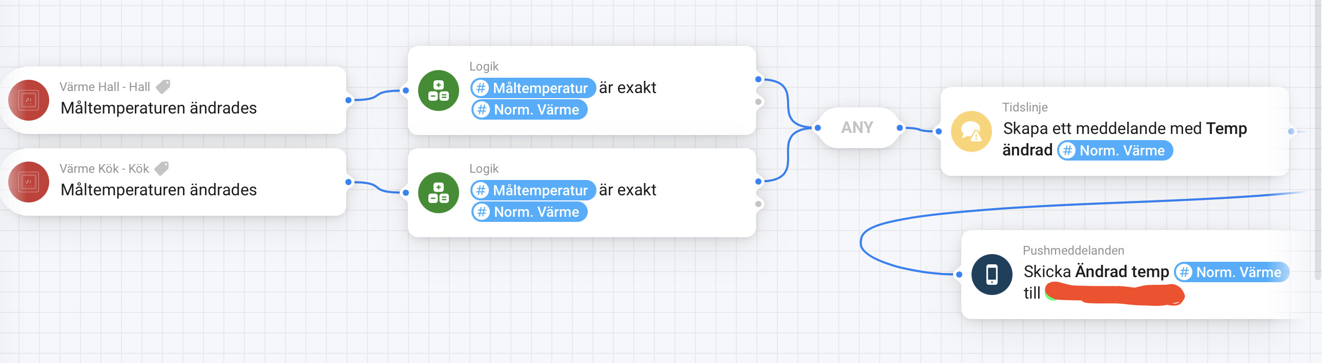

(This is just an example of the flow just to show what I mean. The “real” flow is somewhat little bit more complex.)
Nope, that one didn´t do it either.
Why compare with Norm. Varme? Do you want a message if the target temperature changes or if the target temperature is set to a normal value?
Based on your question, if you want a message if either or both target temperature are changed (but receive a single notification (instead of 1 for each change). With this solution also a 2nd change on the same thermostat will be suppressed

Ok, I made this a little compact, just to try and fit it into one image.
Looks good.
