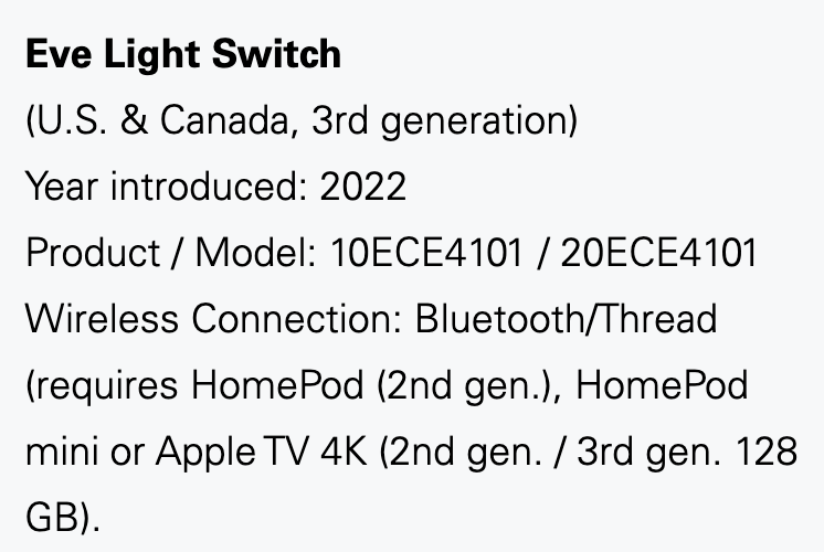

The Eve switches, on their product page, state that they require a HomePod or Apple TV to work :man_shrugging:t3:
Even with HA you’ll need some form of Thread border router to be able to use these devices. You could enable multiprotocol support on the HA Yellow or the SkyConnect to get a TBR working, but multiprotocol support isn’t something you want if you also want to be able to use Zigbee devices, so you’ll need a separate dongle for Thread (or Zigbee).
Yes, I have a HomePod mini for the thread router.
Of course they work completely fine in HomeKit but I would like to use Homey for flows and advanced flows but that is not possible if my switches only work in HomeKit.
